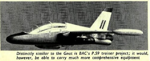

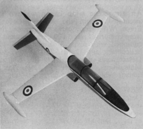

BAC studied two projects for the RAF basic trainer requirement, P.59 and P.62. P.59 was designed around a single Viper 600 turbofan. Speed Mach 0.9, 5,000lb warload. P.62 was designed around a reheated Adour turbofan. BAC were "soft-pedalling" P.62, as it was higher cost.
Air Enthusiast August 1971
Minor correction, Viper 600 is a turbojet, same engine as used in late-model MB.326s & all MB.339s and Super Galebs among other aircraft.

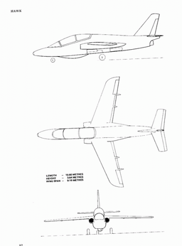

Has anyone got a 3-view of the BAC P59? I ahve hunted through various mags from the 70s to no avail. There must be a brochure out there somewhere.
UK 75
Braybrook's 1984 Hawk book and Peter R March's 1995 Hawk Comes of Age book both have GAs, IIRC. Both boxed somewhere, but I can dig out if needs be in a day or two.
"Only stupid man are tidy, the genius rules the chaos !"
I've found it at once ... :D
(from Roy Braybrook "Hawk" )

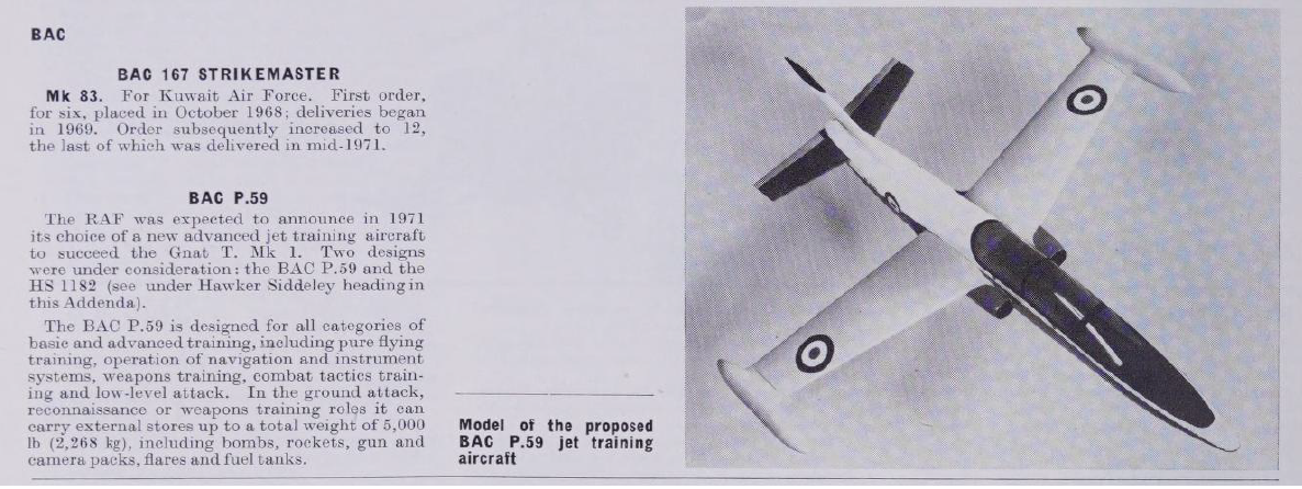

http://www.flightglobal.com/pdfarchive/view/1971/1971%20-%200916.html

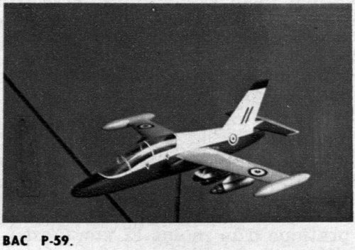

Another view of the BAC P.59 model, exhibited at Le Bourget 1971, from Aviation Magazine 565.

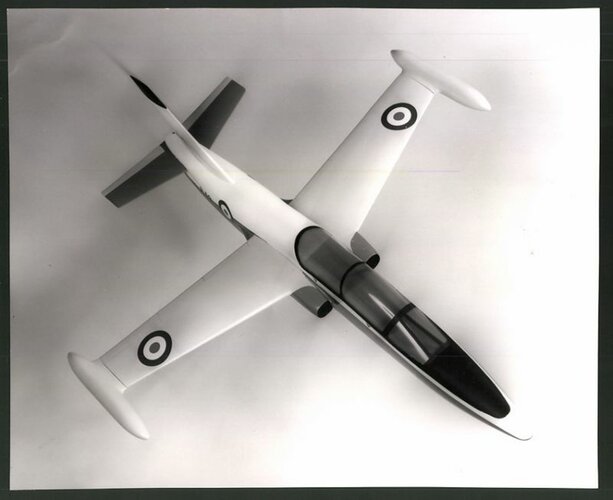

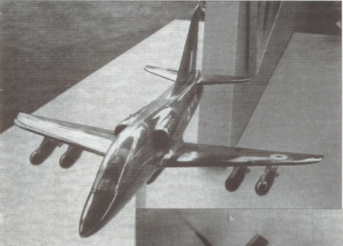

Source: https://www.ebay.de/itm/Fotografie-Flugzeug-BAC-P59-Kampfjet-Modell-/383753670414
The auction at Ebay has ended, but these pictures are still available at oldthing.de.
Links:
So I only will attach one picture.
