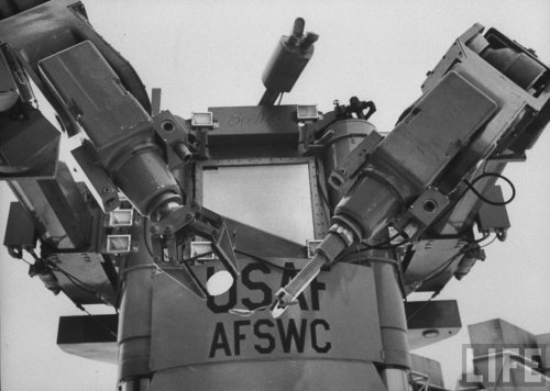

was this really built ... or is this just a mock up or artist view ?

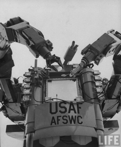

The 85-ton "Beetle" was built by General Electric to work in "hot" environments. Man is stationed inside lead-shielded cab and operates 16-foot arms. Beetle can rise up to 25 feet from ground and rotate in a complete circle.

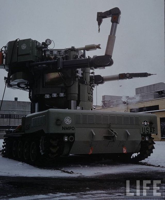

does anyone have an idea what the "gun" on top of the cab is supposed to be?
water spray for decontamination?
Maybe this helps ?
http://oai.dtic.mil/oai/oai?verb=getRecord&metadataPrefix=html&identifier=AD0402748
Many greetings
Revised link for the document moin1900 found: http://www.dtic.mil/dtic/tr/fulltext/u2/402748.pdf

Was this vehicle built to tend NERVA (Nuclear Engine for Rocket Vehicle Applications) powered rockets?

some information
Built by Jered Industries in Detroit for General Electric's Nuclear Materials and Propulsion Operation division,
The Beetle was designed for the Air Force Special Weapons Centre, initially to service and maintain a planned fleet of atomic-powered Air Force bombers. According to declassified Air Force reports, work began on the 'Beetle' in 1959, and it was completed in 1961.
Source

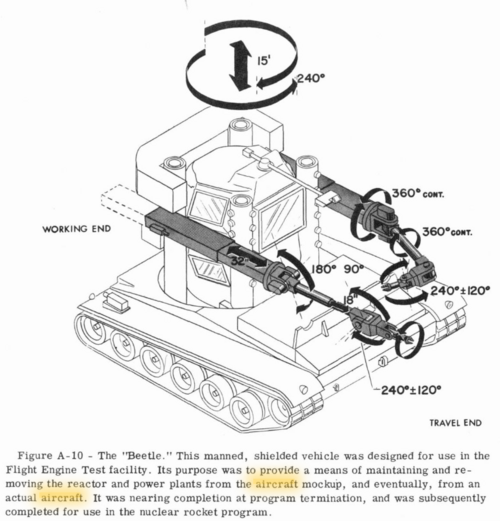

The attached PDF excerpt from a 1962 Project Nerva report provides some information, mostly illustrations, for the Beetle.
There is a 1966 GE report "Remote Handling of Nuclear Systems", available in Google Books, that provides detailed information on the infrastructure and tools developed for the atomic-powered airplane project. Beetle info is on pages 267-284.

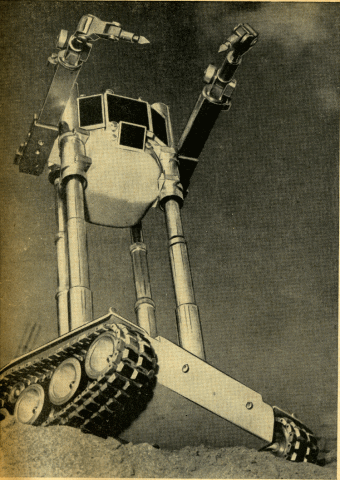

POPULAR SCIENCE
JUNE 1958
PAGE 103
-"NUCLEAR GREASE MONKEY"
Wheeled BEETLE

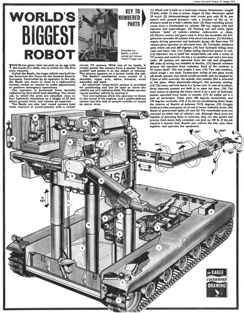

AVIATION WEEK, MARCH 18, 1957
PAGE 27-28
-General Electric Shielded Vehicle
Early Concept Drawing
