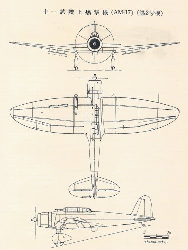

In 1938, the IJN planned to develop high speed land base reconnaissance plane correspond to Ki-15, ordered Aichi to construct experimental type. Aichi began to develop slender monoplane AM-20(C4A1) with fixed undercarriage based on the experience of AM-17 11-shi carrier base bomber design, the chief designer was Norio Ozaki. Mock up was completed in March 1939.
BTW the IJN selected modified Ki-15 as 98 type land base reconnaissance plane, AM-20 was cancelled.
Source: My No.2 bible
Please watch following site which described 98 type land base reconnaissance plane.
http://www.geocities.co.jp/Bookend-Ohgai/3853/jnrs/jnrsC222h.htm

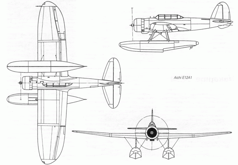

Does anyone think there may be a connection between the Aichi E12A, the 12-shi; am-18 project for a two place floatplane with a Mitsubishi Zuisei engine and the 13-shi, am-20 project for the C4A two place carrier borne reconnaissance aircraft with the Zuisei engine. e.g., would the C4A possibly be a carrier borne version of the E12A?

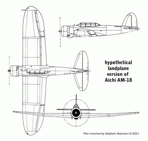

Meanwhile, and just to advance the discussion, allow me to offer this ENTIRELY HYPOTHETICAL landplane version of the AM-18.
Please keep in mind that we have NO GUARANTEE at this stage that the AM-20 (C4A) looked anywhere near this aircraft.

Out of curiousity, why are we assuming the E12A1 as the based for the AM-20? Had not the more successful AM-19/E13A1 had already flown by the time Aichi submitted its candidate for 13-Shi?
A very sound remark I must say. Let's see what we can do with it! ;)

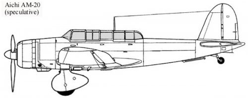

As blackkite has established that the AM-20 has a fixed undercarriage, I offer another speculative view. In this case, I have used the Aichi AM-19/E13A1 as my base (rather than the unsuccessful E12A1). To the floatless AM-19 has been added the undercarriage of the Aichi D3A as well as the Val's cowling for the Zuisei engine.
Speculative of course... but certainly looks good to me... ;)

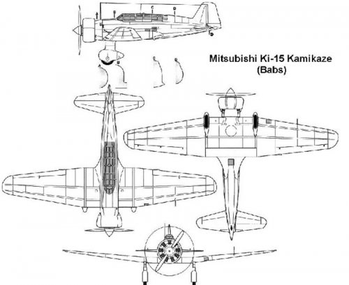

Sorry off topic. But Ki-15's fixed landing gear was rather long compared with propeller diameter.
If landing gear was too short, propeller hit the ground.

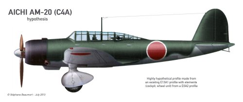

I have reworked an existing E13A1 color profile, notably by adding the wheel unit and canopy of a D3A2. I could have left the one used on the Jake but thought the one on the second version of the Val looked better... Didn't change anything to the engine cowling. Perhaps I should have? What was your logic, Apophenia?

Very nice Stéphane! The Val canopy is certainly sleeker.
My cowling change was motivated by the move from the E13A1's Kinsei to the AM-20's Zuisei engine.
blackkite: Good point on undercarriage leg heights. I based mine directly on the D3A's spatted gear. Of course, carrier types don't have to content with uneven airfields. Maybe that's why the Val's undercarriage legs could be comparatively shorter than the Ki.15's?
