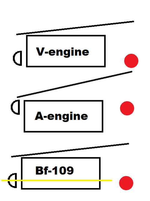

I have made a very professional paint diagram of what I meant.
The red dot is the aircraft center of gravity, the half-circle is the propeller, the sloped line represents the pilots vision and the yellow line is the Bf-109s cannon.
Because the luftwaffe wanted the cannon to fire through the propeller spinner instead of being synchronized and since the propeller has to be in line with the CG the designers had to sacrifice the potential vision benefit of the A-engine by mounting it much higher and running the cannon between the cylinders.
And when it comes to the advantage in looking at the slightly downwards, sideways direction that is not the case in the Bf-109 either. The designers chose to mount guns in the cowling making the Me-109 about the same when it comes to visibility as it's peers (if not putting it behind due to the struts holding canopy glass together.

It is a nice drawing, but from looking at true drawings of the Me109 and Spitfire I would say, it’s not the case. Please not the blue “downward angle” that I’ve drawn (Me 109: 6°; Spitfire 2°) and the inclination of the “looking down angle to the side” (Me 70°; Spit 55°).
Also note, that the exhaust flames disturbed night vision in the Spitfire significantly.

I would say it does match the pilots point of view, please take a look on the first posting of this thread.
The amount of refraction is very angular and glass thickness sensitive so the 109 is a very different to the 190. Therefore you can’t assume the same viewing angle applies to both. Also steep angle come with other real world drawbacks such as sunlight glint and ghosting. There’s an informative explanation of this in an Avro Arrow documentary where they show the effects of different angles and thickness’s.
It's a good illustrative diagram, but the relative location of the propeller to the crankcase is more appropriate for early direct-drive engines, while the WW2-era fighter engines had a reduction gear in front of the crankshaft that displaced the propeller shaft towards the longitudinal axis of engine, in upright and inverted engines alike. I believe that was actually a requirement for the installation of an engine cannon, as the cannon couldn't fire through the crankshaft, as it would have to do on a direct-drive engine, but it could be made to fire through the displaced propeller hub which had a centreline running between the cylinder banks.
