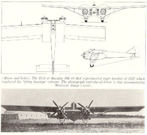

while searching for something else,(this:-http://www.secretprojects.co.uk/forum/index.php/topic,5188.msg41169.html#msg41169 ),
i came across this, Dyle et Bacalan DB 10Bn4.
Dyle et Bacalan DB10 Bn4 experimental twin engined four seat night bomber of 1925.
this aircraft used the 'lifting fuselage' concept, which apparently was developed independently of Burnelli in the USA.
the DB 10 was of all-metal construction,and powered by two Gnome-Rhone Jupiter radials.
pilot and co-pilot occupied separate tandem cockpits, and a gunner's position was situated over the central wing leading edge.
this was equipped with a scarff ring mounting twin lewis guns. the navigator'scompartment was located in the wing centre section.
a bombload of 2,866lbs (1300kg) could be carried internally.
performance:-max speed 118mph (190 kph), max cruise 107mph (173kph) at 13,125ft (4000m), service ceiling 18,045ft (5500m).
empty weight 6,944 lb (3150 kg), loaded weight 12,346 lb (5600 kg)
span 82' 1/4" (25 m), length 44' 7" (13.6 m), height 12' 5" (3.8 m), wing area 1,001.04 sq ft (93m2).
source:- Air International, August 1976, page 94
cheers,
Robin.

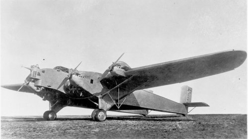

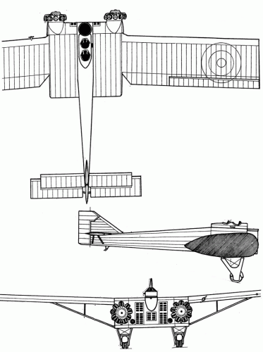

Maveric, it's not what you asked for, but let those DB-10 land here.

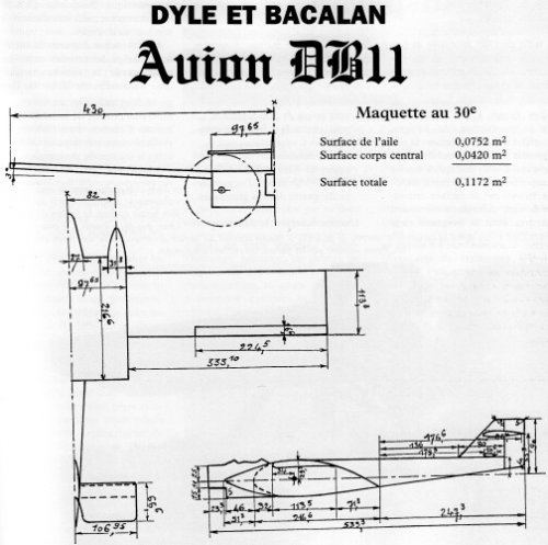

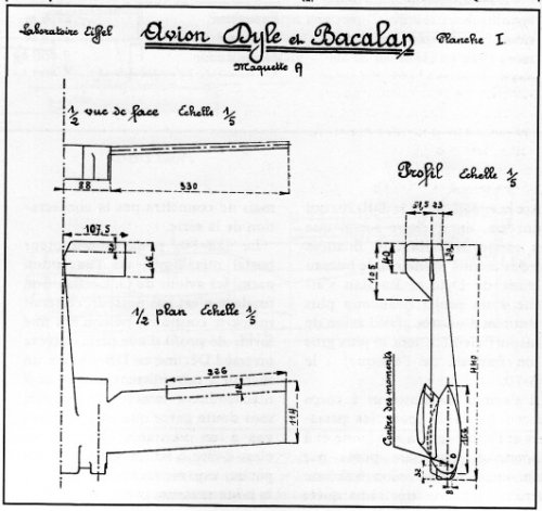

In the wonderful special issue of Trait d'Union magazine "L'aéronautique à Bacalan" (published in 2002, 94 pages devoted to Dyle & Bacalan and Bordelaise) is the "Avion Dyle et Bacalan" model A tested at Eiffel Lab, forefather of the DB-1 then DB-10, with a Burnelli-like fuselage, 1924.

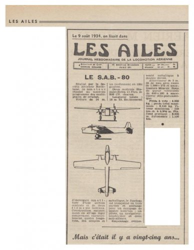

Dear Boys and Girls, here is a reprint article in French about the Société Aérienne Bordelaise AB.80 multi-purpose bomber/reconnaissance prototype from 9th August 1934……
The article comes from the 15th September 1959 issue of Les Ailes......
Terry (Caravellarella)

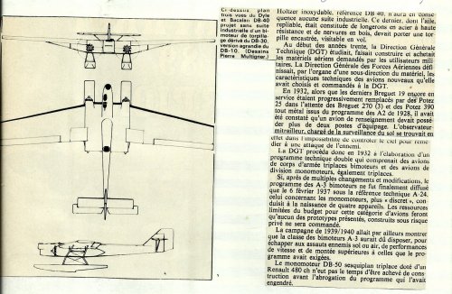

the Dyle et Bacalan DB-40 may be developed from DB-30,and the DB-40 & DB-50 were
mentioned in the Trait d'Union magazine issue 195,does anyone has that volume ?.
Hi all
Here, the db 40 from and old
"Aviation Magazine"
Excellent my dear Toura,
also there is in your picture,the DB-50 which powered by only one Renault engine also
may be that aircraft intended for A.2 1928 competition for observation and combat
aircraft,the main contenders were;
Breguet Bre 270,Potez-390,Dyle & Bacalan DB-30,(may be DB-50),Caudron C.140,
Weyman Wel-10,ANF-130 and Morane-Saulnier MS.152.
What about DB-60 ?.

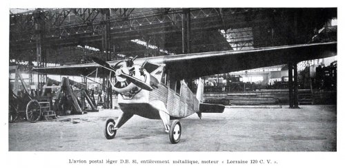

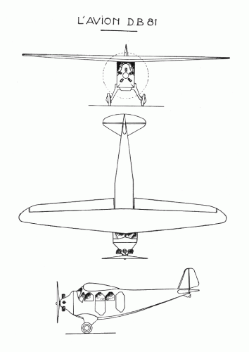

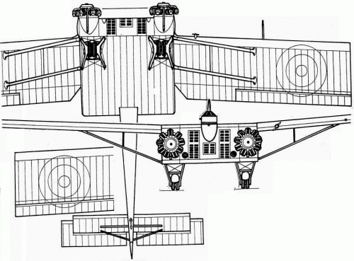

Not seen previously in this topic, the D.B.81 mail transport:

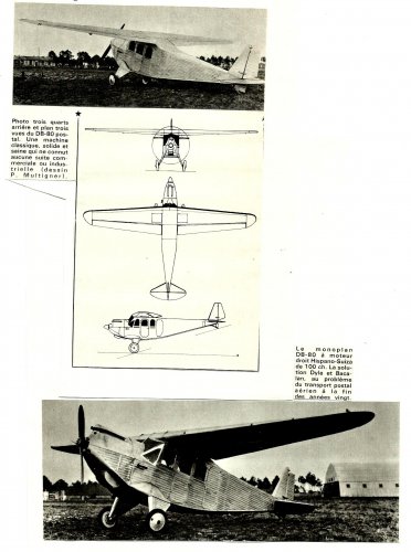

and from "Aviation Magazine"
The db 80

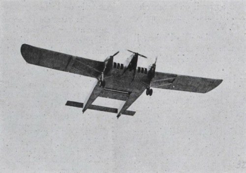

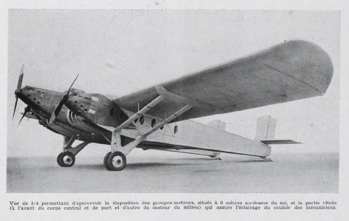

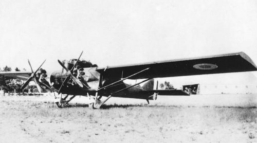

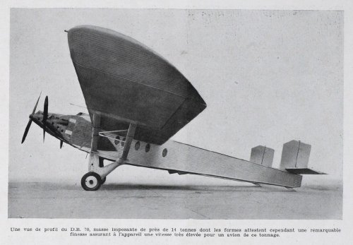

A little less "normal" perhaps (though quite elegant in its own way), the 14-ton, twin-fuselage D.B.70:
Quite obviously, the D.B.70 led to the A.B.20 and A.B.21... First two photos are from another forum topic:

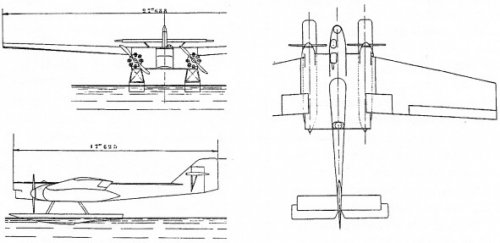

the Bordeliase AB.22 was a five-seat night bomber (BN.5) aircraft,intended to carry 75mm gun,maybe remained
a project only.
the Bordelaise AB.21H was a project for float version of AB.21,intended for torpedo and recce bomber duties,terminated in 1934,and never built.
