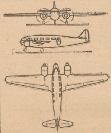

From Ailes 3/1945,
here is a twin engined mid-wing medium postal transport airplane Project,designed
by Georges Valette and called GAV-II Austral.

For Georges Valette's GAV-II Austral, nothing hints at military. It says clearly "transport postal".
"Colonies and and relations with the Empire" means that it wasn't meant for service within Metropolitan France, nor transatlantic. It was meant for postal transport between France and the colonies, and within the colonies.
BTW: Austral is a now-obsolescent synonym of "Southern". No particular link to Australia.
Of course, seen from metropolitan France, the colonial empire of 1945 was very much in the South: Africa, Indochina and Pacific islands.
