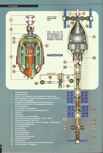

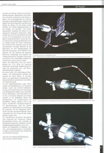

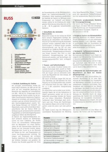

Semi-off topic, because its a little retro futurism: The "nadeshda" and "russ" spacestation concepts were seriously considered as MIR follow-ups. It was accepted in 1999 but soon after the russians decided to take part in the ISS and to have no all russian station."Nadeshda" should be completed by 2007 and operated until 2015. The "Nadeshda" station is technical very interesting and innovativ and used also old components combined with an inflatable section. The article is from an old german space magazine called "Raumfahrt concret" (issue 13/2000). It still exist today and is worth reading. So hope you enjoy it too...
Greetings
Athpilot
attachements modified
I never hear about "nadeshda" and "russ" space station concepts
"nadeshda" is so unconventional for a Soviets Space Hardware, with use of Inflatable Habitat
it use a FGB block with 4 LKS capsule (modified for 4 person each) as core, encase in Transhab like cover
once in orbit it inflated the hull and formed additional work space and serve as basic module for Biological experiments
next to that three FGB module for Experiments: Technology, Astrophysics and a special module (what ever that is)
the Station is equip with very big robot arm who catch Progress Transporters (seem lesson after Progress MIR collision)

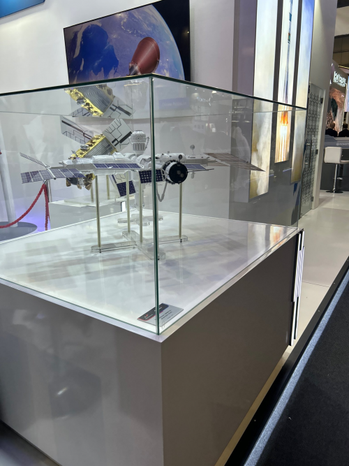

Russia in 2027 may begin construction of a new space station.
General Designer Soloviev: Russia in 2027 may start assembling a new space station.
02:40 08/31/2021
MOSCOW, August 31 - RIA Novosti. In 2027, Russia may start in orbit to assemble a new national space station, while continuing to operate the Russian segment of the ISS for two years , the General Designer of the Rocket and Space Corporation ( RSC ) Energia, flight director of the Russian segment of the ISS, told RIA Novosti in an interview with RIA Novosti . cosmonaut, twice Hero of the Soviet Union Vladimir Soloviev.
"The Angara is being created, but, as my colleagues explain to me, with its help we will be able to launch new modules this year in 2027, when, we hope, the infrastructure at the Vostochny cosmodrome will be ready. That is, we must fly to the ISS until 2028. -2029, in order to close the "junction" between the completion of the ISS and the start of operation of the new station at least two years, "Soloviev said.
The first module will be the Science and Power Module (SEM) intended for the ISS. NEM has been created since 2012. Initially, it was assumed that the module will be produced in 2015 and will ensure the energy independence of the Russian segment of the ISS, which now receives electricity from the American segment. Also, the module is intended for scientific research. However, in 2015, only a draft design was ready. According to open data, the airframe of the NEM module has been assembled since 2017. In 2018, its ground tests began. Module starts are constantly postponed.
Earlier it was reported that the first module of the new Russian space station should be ready for launch in 2025.
It was reported that the station will be designed with an open architecture and an unlimited lifetime due to the replacement of modules, it will be larger than Mir in size, fly in an orbit with an altitude of 400 kilometers and an inclination of 98 degrees, which will allow monitoring the entire surface of the Earth , in the first place beyond the Arctic and the Northern Sea Route.
