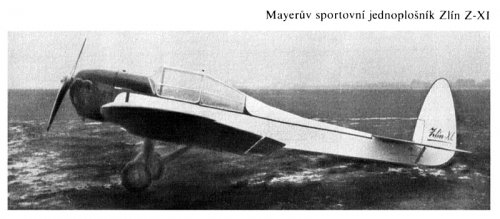

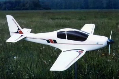

Z-60 was a light aircraft,no more Info.

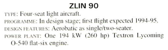

Z-90 was a project of four-seat lightplane powered by two
260hp Textron Lycoming engine.
Z-400 Rhino was utility aircraft powered by 600hp Orenda
Recip OE600 engine.

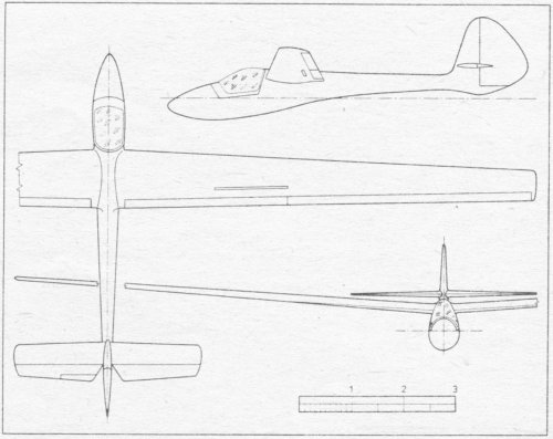

My dear Redstar72,
it is the first time to see your respond here,so I agree with you about Z XIII,but there was also the
Z-13 and Z-113 a glider aircraft of 1946 up to 1949 (not related to Z XIII,a motor glider,which was built
in 1937 in a single prototype),and for the Z-33 was mentioned in the General Aviation for Airlife
publishing,as a two seat trainer and also called PLK-5.
For the Z-41,you are right,but I just displayed it as its original design,and for Z-42,it was
a production version of it with some improvements.

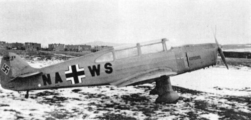

Z.32 also called Let LG.32...

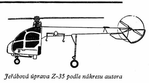

here is a strange crane version of Zlin Z-35,did anyone hear about
it before ?.
L + K magazine.
a full list will be here during next days.

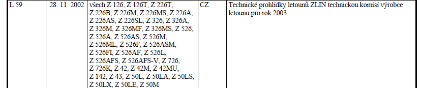

Could you clarify the source? If I'm reading the magazine right, "L + K 24/03" means Letectví + kosmonautika of March 2024. But your reply came nine months before that issue was published. Am I misunderstanding the way L + K dates their magazines?
Hi Zlea,
it's issue 2003/24,the year is 2003 and it's numbered 24.
