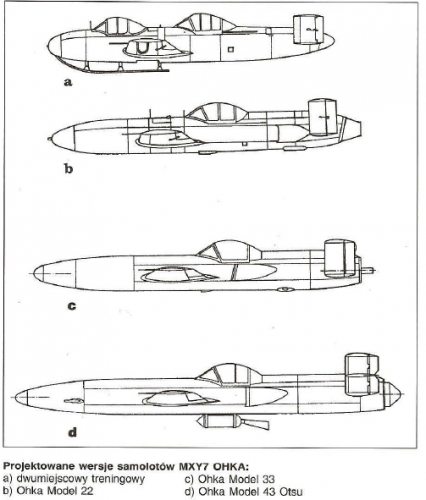

Yokosuka MXY7 « Ohka » ("Baka") suicide plane
Baka(馬鹿) measn fool. It's too hard name for Japanese. :'(
From; Samoloty odrzutowe 1939-1945

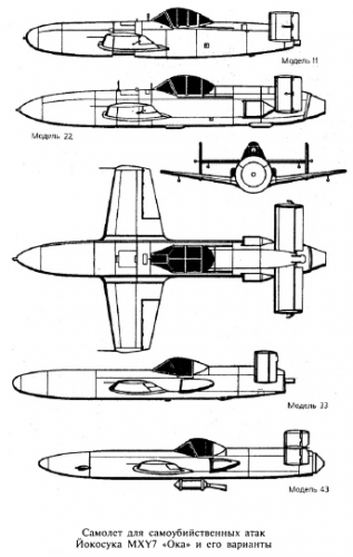

Hi Can anyone cite a Japanese source confirming that "MXY7" was applied to production/operational Ohka, not just to prototypes?
I had read that late-war IJN special attackers didn't receive short designations (e.g. Nakajima "Kikka")...
Regards, Harry
From; Иванов Ю.Г. - Камикадзе. Пилоты-смертники (Мир в войнах) - 2001

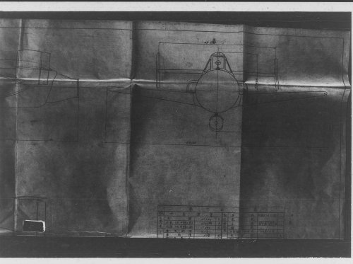

Model 22 original drawing.
