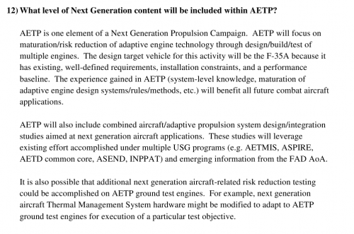

I find some of the remarks about AETP and F-35 compatibility curious since the design target vehicle for AETP is explicitly the F-35A. Possibly the OEMs are being coy because of Congressional language
that prohibits a second engine for F-35.

My understanding is that AETP is to build multiple adaptive engines in the 45k lb thrust class leading to an "EMD" downselect when the program has completed. This started out as a technology risk reduction program. Once AoA for whatever airframe is required has been completed then EMD phase would commence to build adaptive engines for that particular airframe, e.g. will it one or two engines? will it need to run wet? will it need to be bigger? will it need to be smaller? Basically they want a core design that can scale.
I haven't understood the "design target vehicle" for AETP to be "explicitly" the F-35A as far as DoD is concerned. Perhaps if I were GE that would be my target since the government is footing the bill - they've even said as much. But without airframe modifications to the F-35 it would be tricky to include the 3rd stream. That doesn't bode well for a simple engine upgrade. Perhaps a F-35 variant? Or perhaps they'll engineer a solution that fits? Or maybe DoD will accept an 80% solution?

marauder2048 said:
From AETP's Second Industry Day Q&A
Good old fbo.gov!!!
Thanks M!
