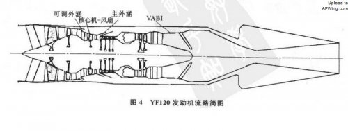

RadicalDisconnect said:
Based on my understanding, it seems that the three-stream adaptive cycle engines of AETD is distinct from the double bypass used in the YF120. Perhaps YF120 was simply more supercruise-oriented?
In the YF120 there were doors aft of the 3rd fan stage that could dump air back into the bypass duct, rather than going through the compressor. When those doors were closed the additional air went through the compressor.
LowObservable
CLEARANCE: Top Secret
Oct 18, 2006
2,180
58
IIRC, the third fan stage on the F120 was driven by the core. That core-driven fan stage (CDFS) was a step in the evolution of the COPE (controlled overall pressure ratio engine) that led in turn to Advent and AETD.
