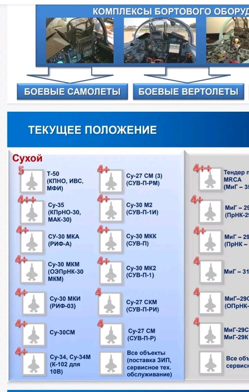

I Found my file Su-27SM3 still use N001VEP Radar like Su-27SKM and Su-30MK2
Is the N001VEP radar upgraded to communicate with r-77 and r-77-1 missiles?
