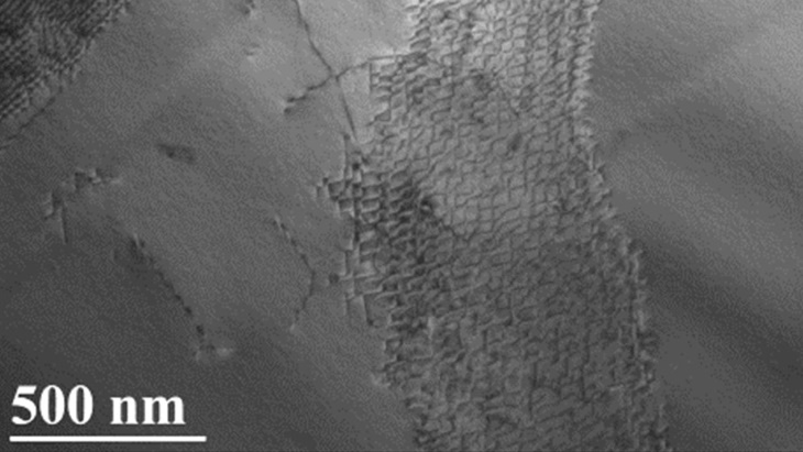

2 dimensional matter made by stacking crystal layers only several atoms thick.
https://news.northeastern.edu/2020/...1.2126096383.1582910361-1597102516.1582910361
The ability to move, manipulate, and store electrons is key to the vast majority of modern technology, whether we’re trying to harvest energy from the sun or play Plants vs. Zombies on our phone. In a paper published in Nanoscale, the researchers described a way to make electrons do something entirely new: Distribute themselves evenly into a stationary, crystalline pattern.
“I’m tempted to say it’s almost like a new phase of matter,” Kar says. “Because it’s just purely electronic.”

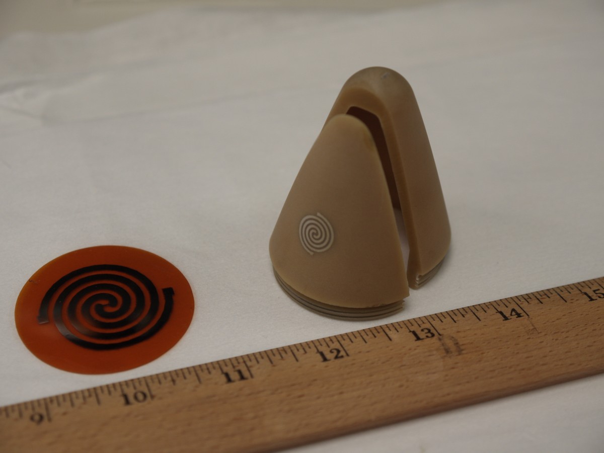

"Through a subsidiary company called Alpine Advanced Materials, Catalyze Dallas turned one of those unused defense concepts, HX5 thermoplastic, into a product with thousands of potential applications. The company touts HX5’s ability to replace aerospace-grade aluminum while maintaining 90 percent of aluminum’s strength and shockingly, at 50% the weight. Beyond the simple weight reduction, HX5 can withstand extreme temperatures and corrosion and has even proven resilient in the vacuum of outer space. "
