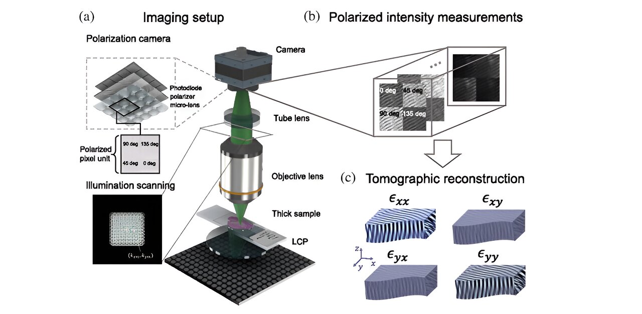

Optics/sensors

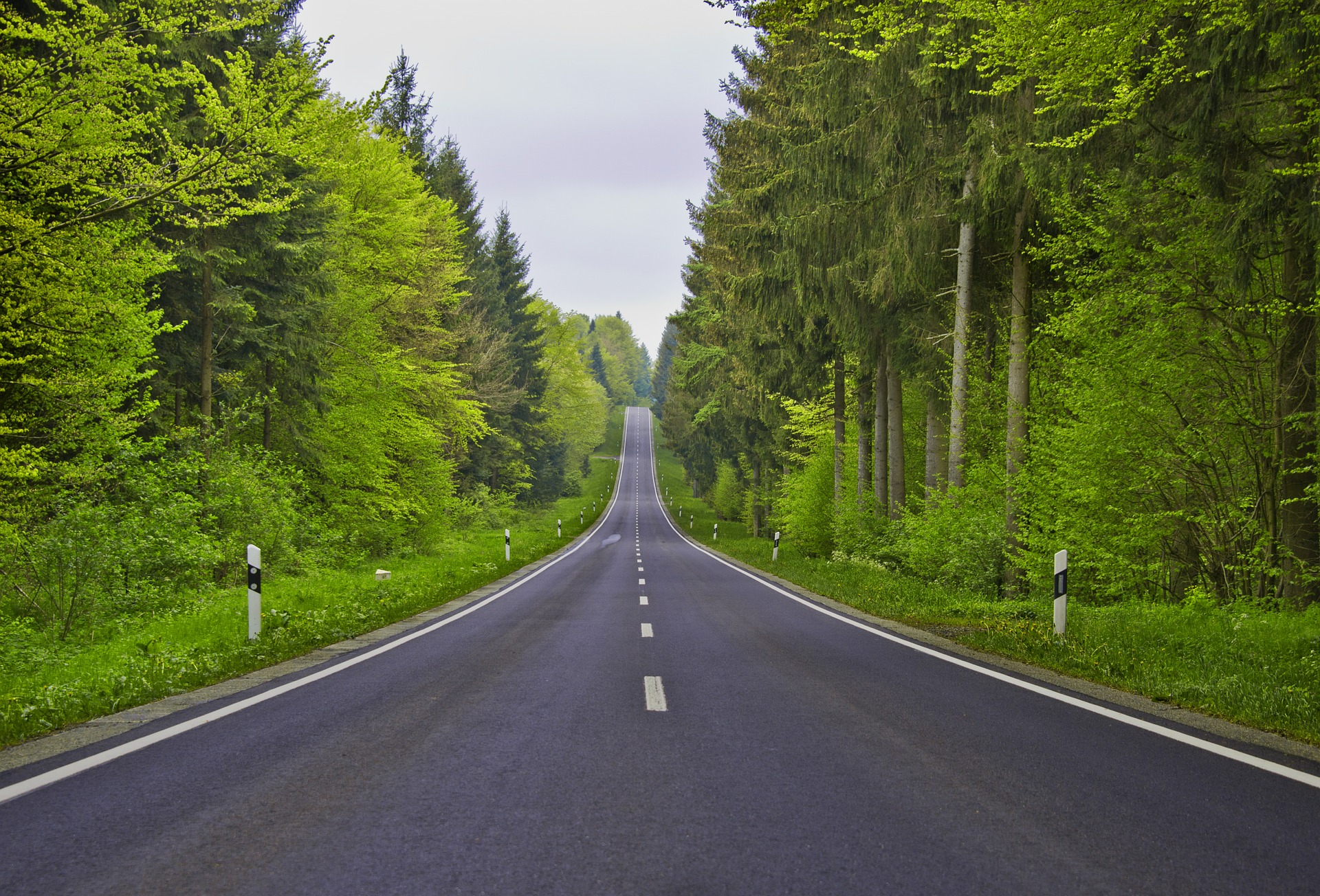

Print your infrastructure or knit it? Who would have thought we'd be asking that question a decade ago?
Interesting that this 'knitted roads' concept has its origins in an art projects at ETH Zurich.
A few links without paywalls:
