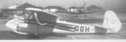

With its bent intake it reminds me very much on the
SNECMA Escopette, a valveless pulsejet tested in 1950
with a modified Arsenal SA.103 glider.
(photo from J.-C.Fayer, "Les Prototypes De L'Aviation Francais")
More about the principles here http://www.invention-conception.com/pulsostatique.php
