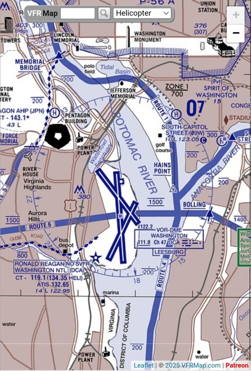

Also, it appears that the helicopter maneuvered off of the routing, placing them in the middle of Potomac and closer to the 3 degree glide slope for Runway 33. If they were at the designated altitude and remained on route then they would have been fine. Obviously, the helicopter was cutting across the Potomac River to expedite their flight to their destination and given clearance to do so with traffic in sight. If the controller would have held them to their route this may not have resulted in a collision. Also, allowing them to skirt across the Potomac would have placed them in front of traffic approaching Runway 1. Keeping the helicopters on their routes, on altitude, would have prevented the accident in my view.
Possible solution: I think the helicopter Route 4 is too close to the approach end of the runway. Of course if they move it further inland and out of the Potomac River then the altitude will have to be raised for obstacles (e.g. buildings, towers, etc.). This would be 1,000 feet over the highest obstacle over a congested city. This would require moving Route 1 further east of the Bolling Airfield. Also, controllers managing helicopter routing and other corridors through their airspace needs to keep traffic on the designated corridors unless they are positively controlled by ATC. Letting the pilot take responsibility of keeping themselves out of the way of traffic in a congested airspace at night against all of the ground lights is a workload intensive endeavor.
You have to think at the nuisance. There is a lot of helo flights each day in this area. Moving the route overland will face strong opposition from home owners.

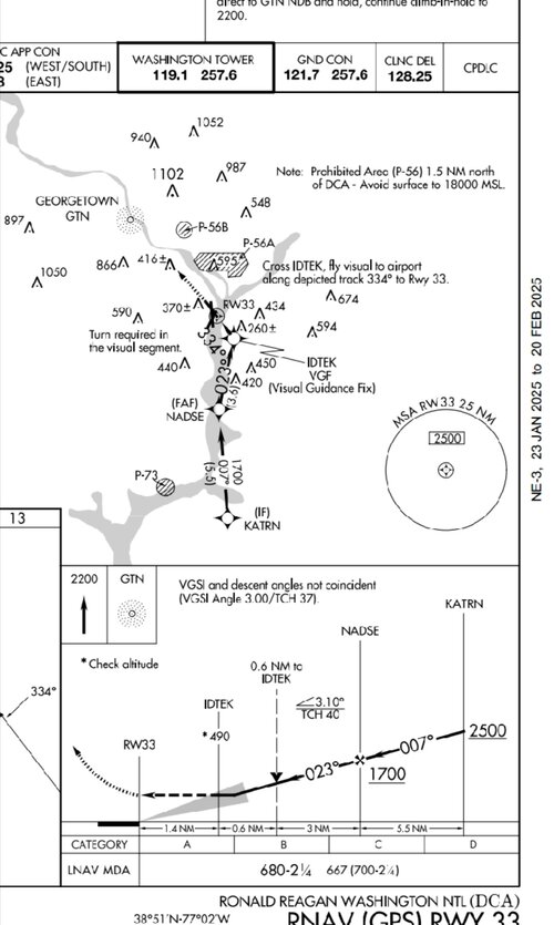

Also note that the approach plate shows that at ~1.5nmi from runway threshold, that airliner should have been at ~490ft agl and descending a 3deg slope.
Runway 01/19 is 7169ft long, ~1.18nmi or so.
The collision happened roughly 0.5nmi from the runway threshold. The plane was actually high above glideslope if they were still at 350ft, the plane should have been at roughly 170ft if they were on glideslope!
Helicopter was not where it was supposed to be. It was in a position where ANY traffic coming from the right-hand side of the aircraft would be invisible to the pilot (edit) of the airliner on approach. And it was square in the middle of the glideslope in terms of altitude!

OTOH, coming down Route 4 you do have to clear the 14th Street bridge complex first. I haven't been able to find a definite number, but they have an air draft of at least 60 feet, and comfortable clearance over them is going to push you right up to near the 200-ft ceiling. Really easy to drift higher, especially on NVGs and with head out of the cockpit instead of fixed on instruments.
where did you get the 0.5nm from threshold for the location of the crash
The impact point on the water was reported about 3,000 feet or 0.49 nm from the threshold. Although, due to momentum of the airliner, the collision likely occurred further away from the threshold. However, if your trying to calculated the height of the airliner at impact, the 3 degrees starts at the touchdown aiming point markers 1,000 feet from the threshold on the runway. Making the distance 4,000 ft from the touchdown marker to the water impact. This is 209 feet AGL above the water impact point on a 3 degree glideslope.
The airliner's recorder had the impact occurring at 325ft AGL. If the airliner was established on the 3 degree glideslope this would have the collision location 6,450 feet from the touchdown marker or almost 1 nm exactly.
The tower recorded had the helicopter at 200 feet. Airport Surveillance Radar updates every 5-6 seconds. Its possible that when the helicopter turned right, towards the middle of the Potomac, that it climbed 100 feet in the 5 seconds before the next accurate radar contact. The Blackhawks recorder hopefully will shed light on the true altitude of the helicopter. Its possible that the pilot of the helicopter climbed for added comfort as they turned further over the water where there were fewer obstacles to judge their altitude above the water while flying VFR.
@Scott Kenny : where did you get the 0.5nm from threshold for the location of the crash? Could you kindly share.
I compared the published length of runway to where the ADSB tracks crossed.
However, @Dynoman corrected me on the altitude the airliner should have been at due to a difference in where the ILS beams put you on the runway. But that still puts the airliner at 210ft in the middle of the river. If the FDRs are correct and the impact occurred at 350ft, that would put the impact point at 1nmi away from the end of the runway. And means that there's only about 200ft of vertical separation between the published Route 4 at the water's edge and the center of the glideslope. Whoever approved that needs to be shot, and have every other decision they have made reviewed by at least a 9-strong team.

Helicopters can hover and alter course pretty easily. It's not uncommon to see military Helicopters doing their things at an airport while you strictly follow your landing pattern or approach.
200ft airway still require a clearance to cross the airspace (see chart)
Yes, and the clearance was at least partially inadequate since even if everything worked perfectly the helo would pass directly under the airliner.

The Runway 33 approach leaves every aircraft UNABLE to see any traffic to their right, due to the sharp left turn. Big bank angle, puts the floor of the cockpit between the right seat and anything on those helo routes!
