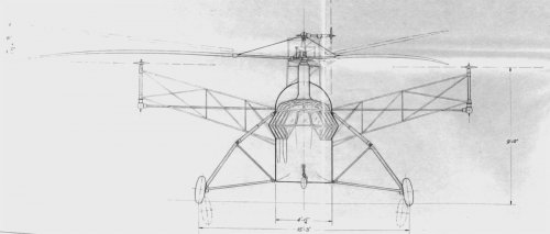

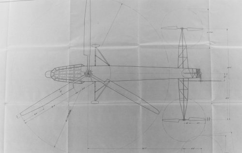

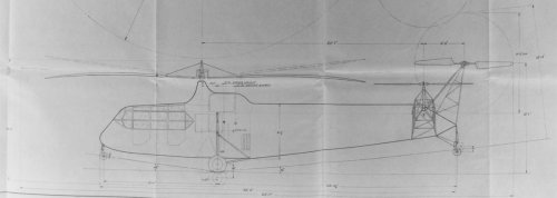

Here is a general arrangement of a Rotating Wing Aircraft proposal the Vought-Sikorsky VS-311
The aircraft was designed in response to Air Corps Proposal 40-260 dated 12-20-39 as amended
5-28-40. From the VAHF archives.
I have some Inboard Profile drawings coming up.
Does anyone know anymore of the Air Corps proposal, did it lead to the development of an aircraft like the R-4 (VS-316)?
bill

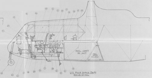

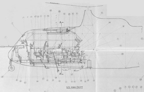

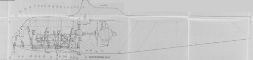

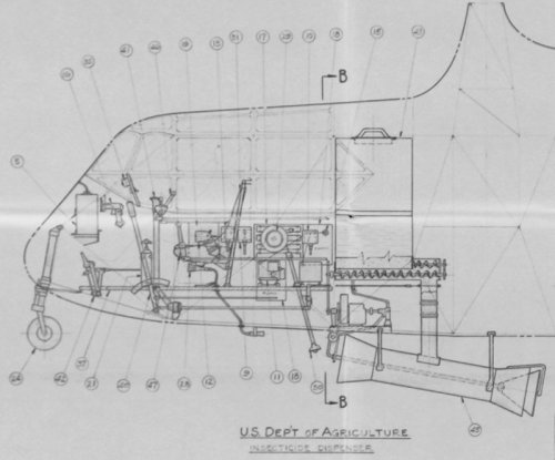

Here are the Inboard Profile with a different series of uses for the aircraft.
For the War Department it shows a gunship
For the US Postal Service it shows a 500lb mail payload
For the US Agricultural Department it shows an Insecticide Dispenser
And a view for an Experimental Ship.
bill

What an AMAZING find! Designation wise, this makes it Sikorsky's FIRST helicopter design after his VS-300 and -300A prototypes, which makes it even more amazing given how advanced a design it is!
I can't say enough how grateful and indebted I am to you Bill S for digging this one out. A million thanks!
