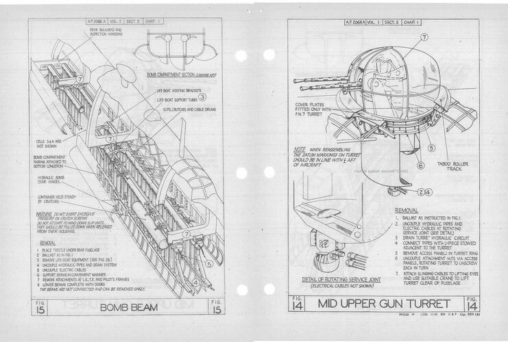

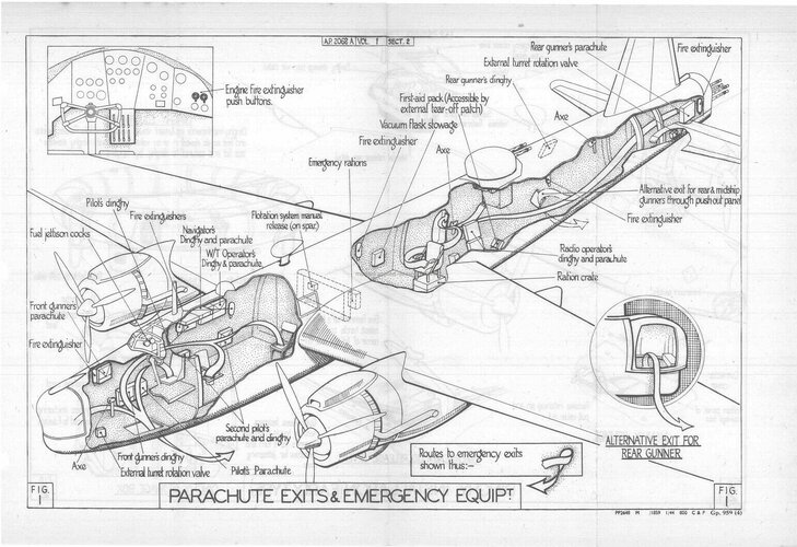

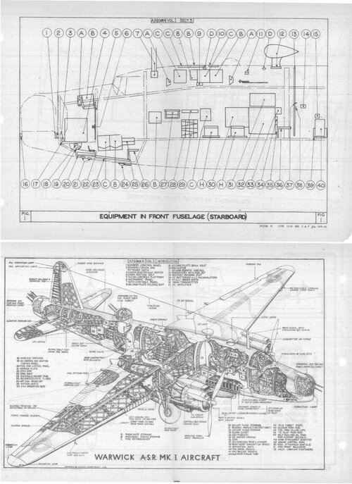

I hope this can help you: Vickers Warwick maintenance manual
I know in one of the pics it says "FN 7", but from what I can see I really think it's a Nash & Thompson FN50.

Looks like you are right, British Aircraft Armament Vol 1 says FN50
That's very odd. The caption sort of implies that the 'taboo track' for the FN 50 made the FN 7's cover plates unnecessary.
Perhaps the FN 7 was in the original plan. But, as on Manchester, the cramped FN 7 was eclipsed by the superior FN 50?
