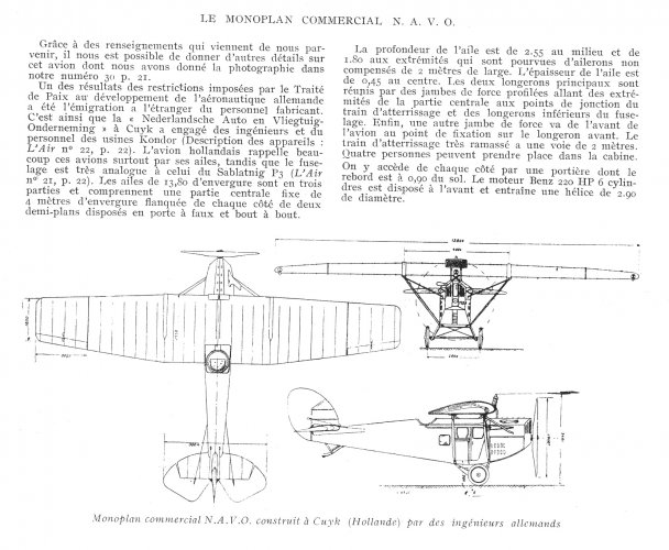

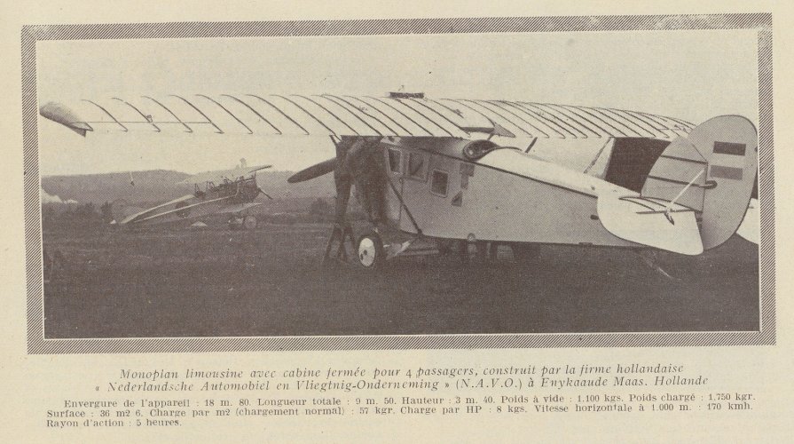

NAVO N.A.V.6 Limousine 1920
The Dutch Automobile and Aircraft Company wanted to start an Amsterdam-Berlin service with a self-built aircraft.
Trials at Soesterberg were postponed and ultimately canceled due to repeated engine problems.
The aircraft was also offered to KLM and shortly afterwards the company was closed down due to a lack of resources.
The device was stored in Soesterberg. In 1925, the Maas en Waalsche Bank in Nijmegen inquired about the condition/value of the device.
and the possible demolition value of the aircraft and engine.
The C. LVA answers that the value was nil and at the same time asks whether demolition can proceed.
The aircraft will also have been demolished shortly afterwards.

Some information, in Dutch, on that aircraft can be found at https://cuijksarchief.nl/node/228/van-cuijk-monoplane
A relatively good translation of that text seems to be available via https://cuijksarchief-nl.translate....noplane?_x_tr_sl=auto&_x_tr_tl=en&_x_tr_hl=en
