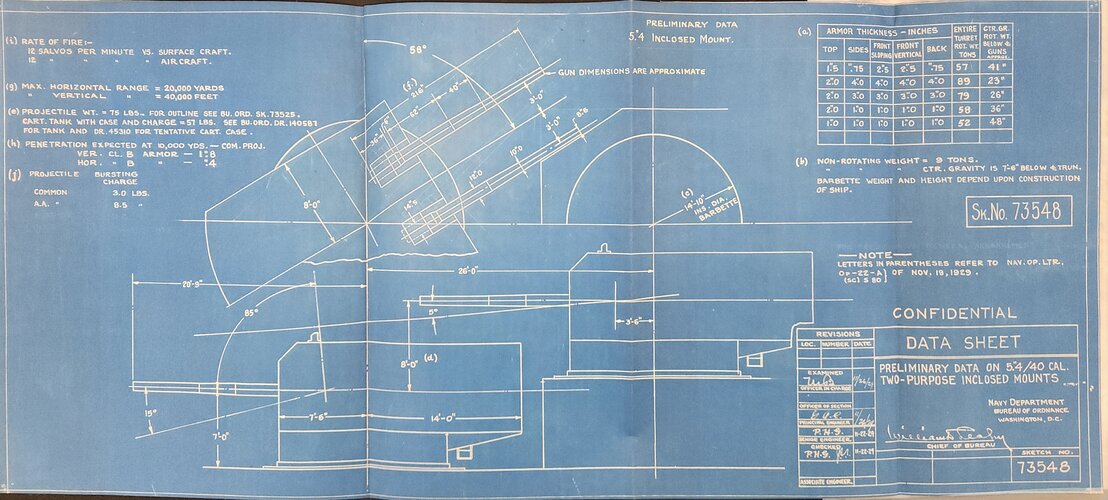

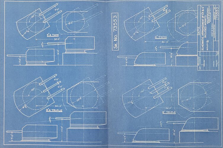

Thank you! Any other info on the 5,3/5,4" gun? Muzzle Velocity, turret shape?
It would have been a twin mount but there are no sketches. It would have been powered in train and elevation, as well as loading (but still requiring manhandling from hoist to feed tray). The intent was for new battleships to have 18 5.4"/40 guns (9 twin mounts) in place of 8 5"/25 and 12 5"/51 in older ships.
Velocity was 2,600 ft/sec with a range of 20,000 yards and a ceiling of 40,000 feet.

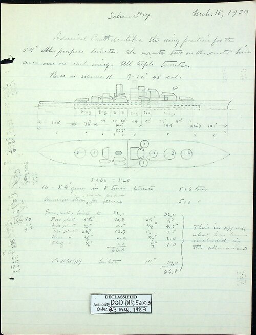

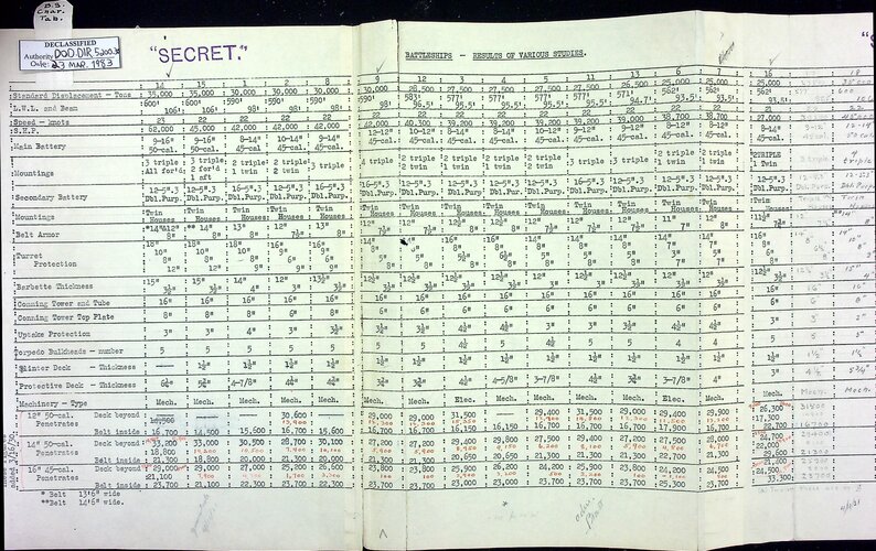

Actually 8 twin mounts were envisioned for the 1928 series of battleship designs. But reading Friedman's description on these is quite difficult....
Is there an MV value for the 5"/40 direct predecessor of the/38 gun?
Any designation mentions? Say Mark A or Mark F etc?
Quite possibly this is the difference between BuOrd's idea based on the weights of the various mounts and BuShips' ideas of what they could actually arrange on the ship. That ninth twin mount would have to be on centerline, which was in short supply on those designs, IIRC.
