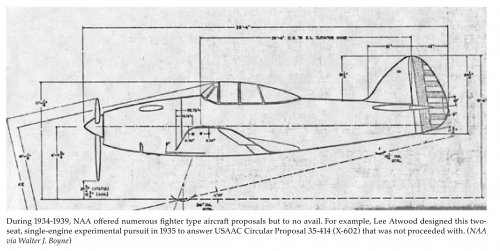

X-602-----CP35-414/Consolidated Model 26/XP-33, North American Model ? and ...

Fantastic - now you can add this one too from my new Mustang book. The Consolidated XP-33 came from this. -SP
