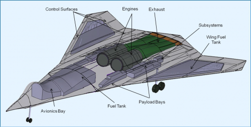

Northrop once developed a concept for the F/A-XX supersonic strike fighter featuring a double-swept wing configuration and engines analogous to the F119. To achieve a combat radius of 1,200 nautical miles (2,222 kilometres) and a maximum take-off weight approaching 100,000 pounds (45.4 tonnes), the design required a leading-edge wing sweep angle of roughly 35° to boost lift-to-drag ratio, which capped the aircraft’s top speed at approximately Mach 1.5. Evidently, the performance limits of existing low-bypass-ratio turbofan engines are insufficient to meet the operational requirements of next-generation high-performance fighter jets.
Does anyone know more details about this concept?I’m not sure whether this diagram comes from original concept or is just the author’s own theoretical deduction.
  • 图:诺斯罗普·格鲁曼FA-XX的可能.png

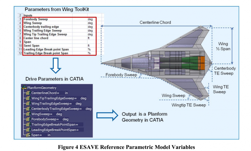

The original image came from a northrop PPT slide that may or may not have had anything to do with ESAV. All the original ppt slide talked about was a parameterized auto modeling software for aircraft. The numbers you see are actually backfilled by the author (and the guy posting it is most definitely not the origin of the corrections either) because the original slide had large writing covering a lot of numbers. I wouldbt use that slide for anything because again - its purpose was to demonstrate parameterized aircraft design software.
I dug into the origin of this photo when we were trying to 3d model hypothetical F/A-XX designs.
That is why the Lockheed NATF and both proposals for A/F-X had swing wings.
Not going to lie, I would not be surprised if the FAXX had swing wings.
I found the slides you mentioned on the forum, yet I can’t identify any specific correlation between the diagram in the paper and this slide. Could you track down the paper or presentation slides where this diagram originally appears?

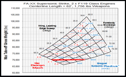

The 1200 nm combat radius target and 45 tonne max takeoff weight have nothing to do with F/A-XX. We now know F/A-XX’s combat radius is a little shorter than F-47’s 1000 nm. This specific number comes from the combat radius target cited earlier as an example for Japan’s next-generation fighter jet.
Also, in my opinion, this chart locks the fuselage length to 18.9m. We’d have more design flexibility if we allow longer fuselage.
Are you certain of that?
“probably over 125 percent of the range that we’re seeing today to give us better flexibility operational reach,” Donnelly said. “So it will definitely have longer inherent range.”
I calculated it based on 125% of the F-35C's combat radius.
MTOW I am. That's set by the catapult, and the EMALS is said to be able to handle 90-100klbs depending on who is talking. France has said 45 tonnes.
But the tighter limit is landing weight. F-14s landed at 55,000lbs. 3000-5000lbs of fuel brings us down to 50-52klbs, and if you want to recover with missiles those have to come out of the landing weight as well. 4x AGM-158s + 4x AMRAAMs is right at 12,000lbs. Which brings empty weight down to 38-40klbs. Tomcats were 43.7klbs empty, RA-5Cs were ~42klbs "empty", and A-3 Skywarriors were ~40klbs. So assuming a very significant composite percentage to reduce weight, I think 40klbs empty is reasonable even for an airframe with huge internal bays. Case in point, the Su-57E is supposed to weigh 40,800lbs empty.​
And tico has given the quote for range. 125% of F-35C is right at 800nmi, and that was "A-6 w/ 4x2000lb" combat radius.
