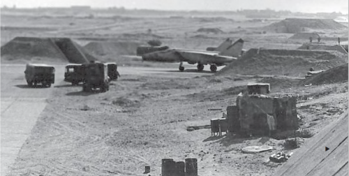

And during early 1970s,Egypt had a four Russian MiG-25R,and President Sadat offered to
purchase them,but USSR refused,if we had them,we could intercepted SR-71 in the air.
A rare picture to MiG-25R operated in Egypt early 1970s.
Aeroplane Monthly 1/2016.
