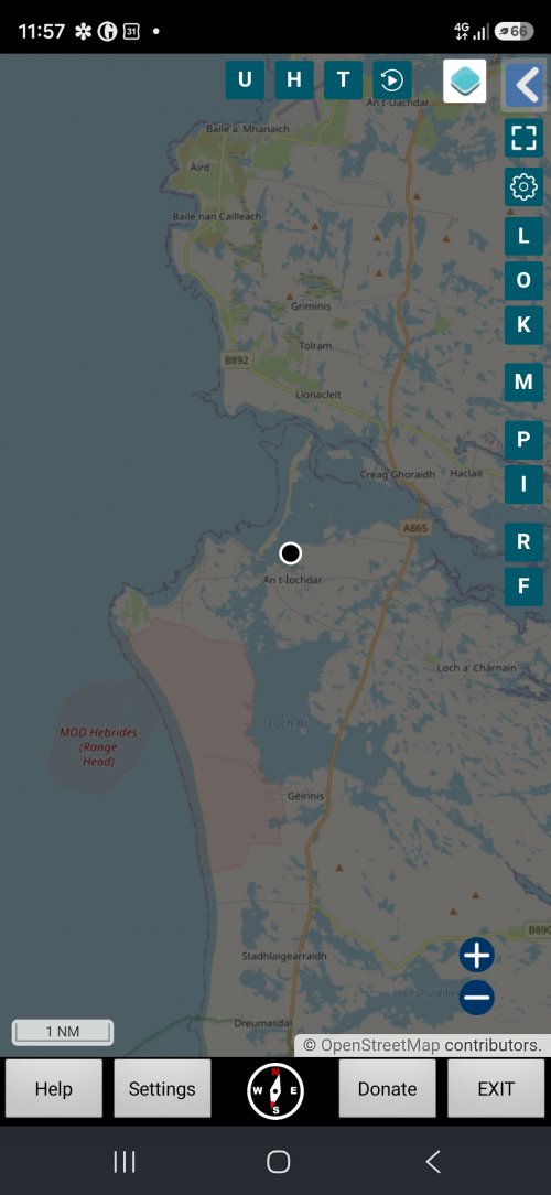

There's a prop and a jet powered one. Jet powered one was delivered to Ukraine as a strike platform so could be connected. Or could be an AD exercise. Suspect the range is heavily booked at the mo...the Typhoon APKWS work will be ongoing as well...
I think all of the Brakestop drones on their first flight will follow a set flight path then be crashed...
This was a prop job. Was watching it with the bins, then saw a puff of smoke and the chute deployed, which was when I swapped to the phone for snaps.
Missus was perusing the jewellery shop, I was outside with my father-in-law. Not the first time we have shared an unusual sighting.
Chris

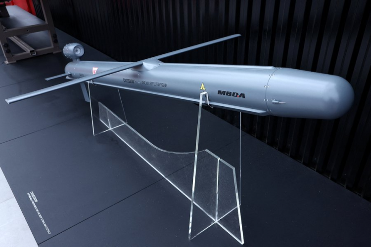

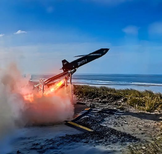

MBDA validates the first firings of the CROSSBOW, nine months after the launch of the program​
https://opexnews.fr/mbda-missile-crossbow-eurosatory/
The aircraft itself measures just over 5 meters, weighs 750 kg at launch, and can carry up to 300 kg of payload, kinetic or electronic, to a range of over 800 kilometers. In subsonic flight (approximately 600 km/h), it navigates using a combination of inertial navigation systems, enhanced anti-jamming GPS, visual terrain recognition via artificial intelligence (AI), and terminal sensors. This layering of guidance modes is a direct response to the conditions encountered in current theaters of operation, where Russian satellite jamming is commonplace.
CROSSBOW is not intended to compete with the Storm Shadow or the future land-based cruise missile that MBDA plans to launch after 2029. It fits between two existing categories. Below them are reactive artillery systems, which have a shorter range. Above them are sophisticated cruise missiles, which are too rare and too expensive to be used on every intermediate target.
