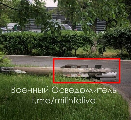

No way is this much of a PAC-3 going to survive an impact intact:
I'd agree with you if it was a direct impact however if it was a near-miss with the PAC-3's proximity-fuse firing its' small lethality enhancement device then there'd be more substantial wreckage leftover.
That one is likely a failed launch. My guess is that the launcher was pretty hot after launching 15 missiles in a very short space of time and the heat caused the last missile to fail on launch by compromising the body.
Wouldn't the PAC-3's design take this factor into account?
It wouldn't surprise me if they never launched all 16 missiles in the space of 2 minutes in testing. Of course it could equally just have been a dud.
Eyeah this is the type of deal that both the Military and Manufacturers plan in alot of extra and hope for the best.
Cause going full hog rapid fire testing like that is FUCKING EXPANSIVE.
With more then a few beancounters not seeing the point. So getting the money rarely happens, or get cut at the last second.
And this will not be the first time that Design Specs does not keeping up with real life battle conditions in this war.
On top of that the US probably donated the oldest missiles it had, which is going to up the failure rate.
