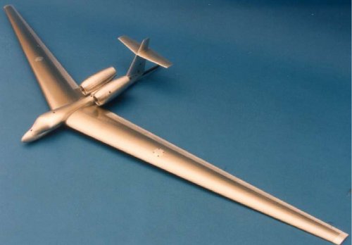

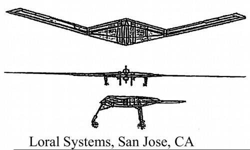

Loral, Frontier Systems, Fairchild Systems is believed to be W570.
So there are two remaining competitors:
Raytheon, Lockheed, Allied Signal and Teledyne Ryan Aeronautical, E-systems, GDE systems, Adroit systems.
Does anybody have any additonal material. Also - is anybody able to identify this design, that seems to be the Tier II Plus proposal?

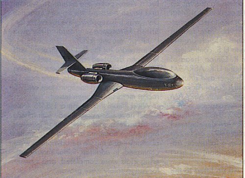

E-Systems also paired with Grob on an Egrett variant for Tier II+
Read here:
Although the Global Hawk and the two Rutan collaborations (Northrop Grumman and Orbital Sciences) are generally known, there were quite a few interesting Tier II+ contenders that sank into oblivion. My favorite is this, from Mission Technologies of Hondo, Texas. According to Flight International 1-7 June 1994, this "twin-wing, twin-boom, twin-engine aircraft would have 24h endurance. With a 28m wingspan, the take-off weight would be 1,600kg".

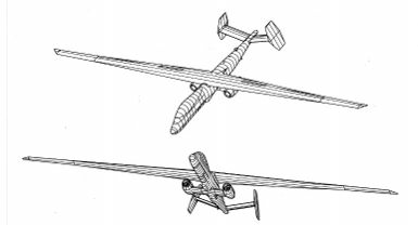

Cool. I had never seen this. :)
Isn't 1,600 kg a little bit light for this class of vehicle? I mean, the latest Global hawk block 40 carries 1,600 kg of payload.

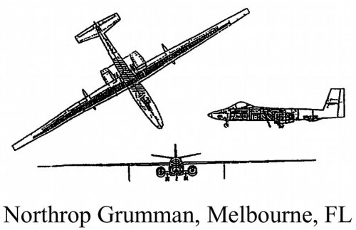

The NG flying wing model is pretty cool :) I wish the 3 views were a little more detailed for the modelers, but you take what you can get.
From PDF...
Matej's design above is similar to the Northrop Grumman proposal.

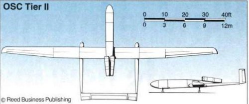

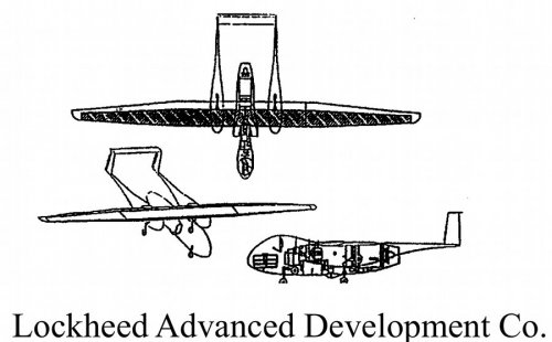

Do you confirm that these photos all depict Northrop Grumman proposals? The one at the bottom is very different from the rest.

That Northrop-Grumman proposal... Does it remind anyone else of the YA-9?

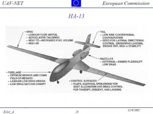

Similar but not exact. Now I can identify my first image as the IAI HA-13 - early Tier II+ proposal.
The sketch of the Loral bid doesn't show the radomes...a big one on the top and the bottom. Roughly tripled the thickness of the fuselage at that point.
There are other significant differencies. For example original W570A had straight trailing edge (only with the end of the wing in angle), while this proposal has the sawtooth.

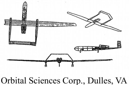

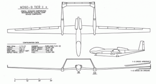

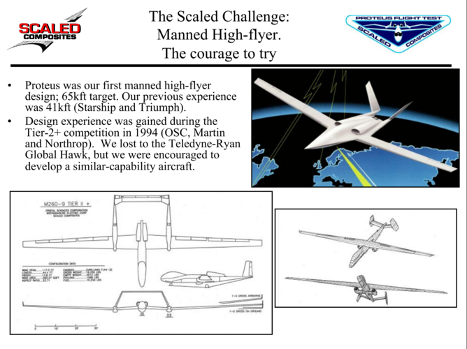

Tier II+ proposals from Northrop Grumman, Orbital Sciences and... Martin.
All with Burt Rutan/Scaled at the design helm... ;D
Nice compilation Stephane!
the second picture shows a tail configuration that would later resurface on the Firebird, with the distinctive canted vertical fins.

Thanks a lot, flateric! Didn't realize the Martin Marietta design had ever been published at the time...

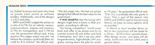

One thing I find interesting is this sentence: "Additionally, one of the designs is a B-2 lookalike".
Since we haven't seen the Loral entry, and since Loral is known to have produced a flying wing UAV later on, can we see this as an indication that the "B-2 lookalike" might be the Loral proposal? Just a thought.

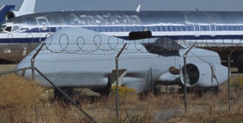

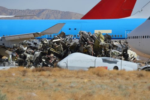

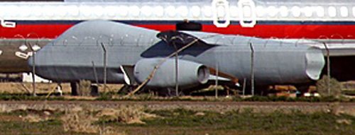

current state of NG/Scaled Tier II+ entry mockup
photo (c) David Wirth

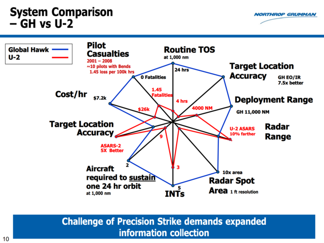

Somewhat on topic: Page 10 has a comparison of real world use of the U-2 vs GlobalHawk
Love that spiky, star-shaped graphic.
Interesting how manned versus unmanned only intersect on targeting accuracy (on the left side of the graph), but the exact targeting accuracy ratio appears on the right side of the graph????????
Also enlightening is the note about 10 pilots getting "bent.".

Hmm...TRW/IAI entry details in this source is far, far away from HA-13 as described by IAI in their own presentation as Tier II Plus offer and shown above in this thread.
