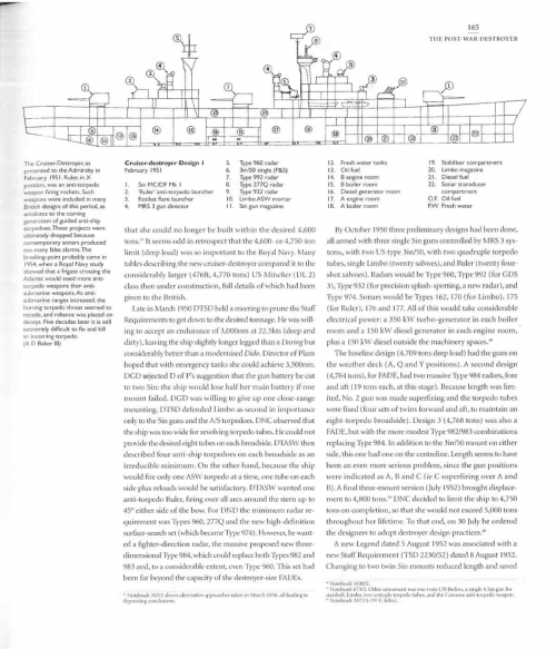

The following 3 are from Friedman's book and shows the 3 as I call them Pre-Designs or Proposals with which the entire design process started.
Proposed by Rear Admiral Sir Ralph Alan Bevan Edwards and refined by DNC and Friedman sourced it to DNC Papers Volume 78 (National Maritime Museum (Brass Foundry)
