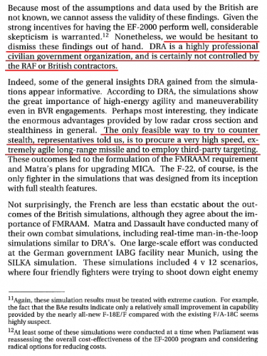

In the mid-90's, British researchers at DERA told RAND researchers that "The only feasible way to try to counter stealth, representatives told us, is to procure a very high speed, extremely agile long-range missile and to employ third-party targeting." (see page 29, The Gray Threat published by RAND in 1995)
It seems the British are really walking the talk, by developing the Meteor ramjet missile and trying out third-party targeting - the first test was done in March 2009.
The question is, what others are doing and will it work?
