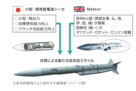

basically a missile with existing British feet, and a new Japanese head

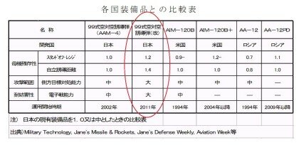

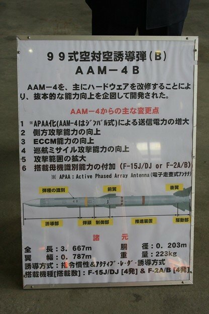

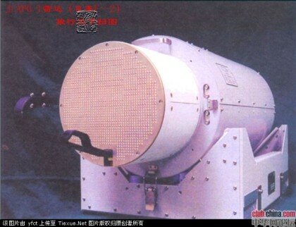

I did not know that F-2 about the AAM-4 having a AESA seeker, thanks.
F-15J uses it too, probably more prolifically. Mica NG will have an AESA seeker but I’m not sure if it’s in service. The UK and Japan are working on putting the AAM-4 seeker on the Meteor as well. AAM-4B is the only one I’m sure is in service though.
Liking the sound of the Meteor getting the AAM-4 seeker. What would AESA radars bring to air to air missiles over the normal seeker heads that are in use right now? Faster tracking?

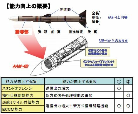

I thought it was a more generic seeker that obviously includes learning from AAM-4, but is not the same seeker
Yea, it’s based off the AAM-4 seeker but correct it’s not literally the same. AAM-4 GaAs seeker, JNAAM GaN.

According to Japanese sources (no hard evidence in document), the biggest reason JNAAM was shelved was due to the French opposition, since Meteor missile seeker is a joint programme between Thales and MBDA's seeker division. They feared that they would lose workshare to the Japanese since the JNAAM seeker was essentially a Japanese design and product. There are also other problems mentioned as well, but also unconfirmed. Anyways, if true, it will mean that joint Japan-Britain AAM for GCAP will be developed from scratch. I'm not sure if the British counterpart would be willing to fund a new missile so soon after Meteor. They probably would utilize seeker technology Japan transferred during the JNAAM programme. Same for Japan.

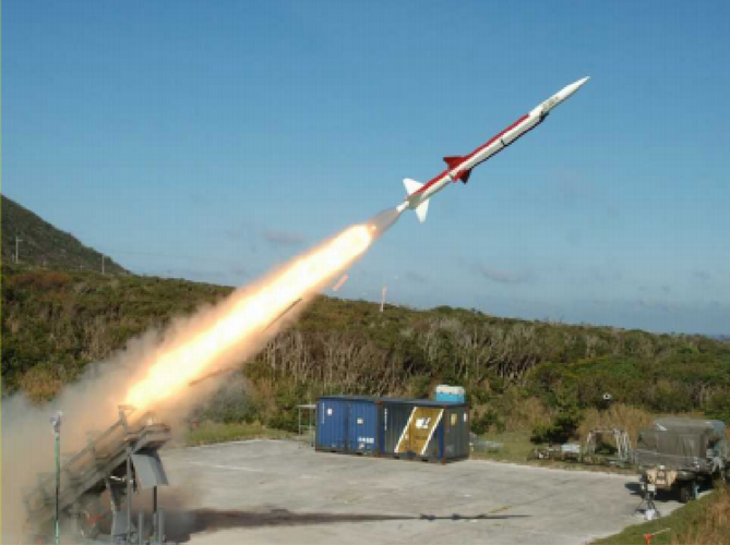

One thing I noticed after JNAAM was canceled is that Japan actually made a ducted version of the AAM-4 prior to that program back in 2007. In this configuration it has an extra booster for ground launches, but perhaps we could see this missile revived post JNAAM.

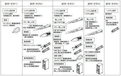

Apparently the research project since its inception in 2018 was always planned to conclude at the end of FY2023 (March 2024) with no program funds after that year. Indeed those Japanese slides say they don't plan to enter production immediately at the end of the testing program but to take their time evaluating the live fire testing data.
Its likely that they will proceed to a larger design based on the more spacious payload bay of GCAP rather than continuing to design the compact version to fit the F-35B's bays accepting they could just carry it externally.

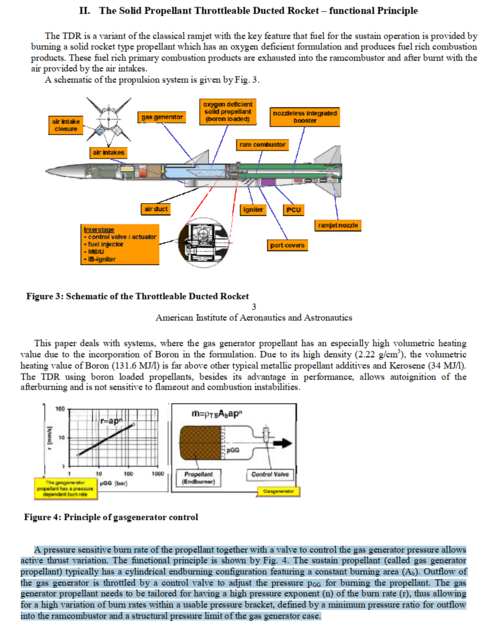

What nonsense you wrote. Air-to-air missiles use solid fuel in their composition, they cannot regulate the thrust or the burning rate of fuel, unlike such missiles as 3M8 or X-31A, P, 3M80, etc. where liquid fuel is used.Gorenje They will always have increased drag, because the rocket is moving at supersonic speed, and an additional shock wave is formed at the entrance to the air intake

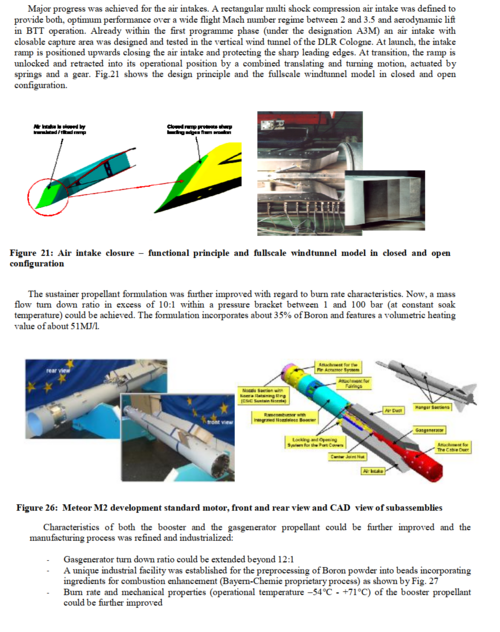

CFD meteor
  • 9677-Article_Text__Manuscript-29978-2-10-20161031.pdf
Do some basic research before you claim something is nonsense.
Ability to throttle down is literally the reason why Meteor can get extreme NEZ with such small missile
Not only that Meteor can reduce the burn rate, it can actually reduce the burn rate by 12 times
Drag is proportional to speed square, slower velocity mean lower drag, simple as that.
Сопротивление пропорционально квадрату скорости, меньшая скорость означает меньшее сопротивление, вот и все.
the resistance is still orders of magnitude higher than that of conventional missiles, and the problem with the angles of attack and sliding has not gone away, since the RAMJET uses air as an oxidizer.So a flight above 20km is not possible
Judging by this phrase, the Gas generator turn down ratio could be extended beyond 12:1, here it means the inlet pressure can vary within these limits, and not the fuel consumption during gorenje
the consumption ratio of 10:1 most likely means that 10 kg of air is required for the combustion of 1 kg of fuel, and not 14.7 as with kerosene
Trends in the development of RAMJET in air-to-air missiles are not yet visible. The only serial representative of MBDA Meteor, although this type of engine was developed a long time ago. But not Russia, the USA, China, Israel do not switch to air-to-air missiles with RAMJET. Instead, the P-37M, PL-21, AIM-260 are made (questionable)
