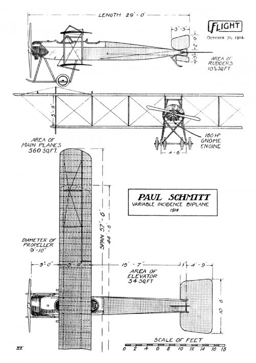

- the Société des Aéroplanes Paul-Schmitt won a FF 30,000 bonus for its variable-incidence biplane.
