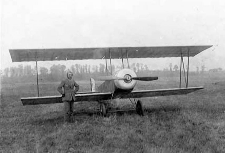

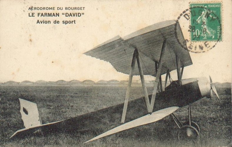

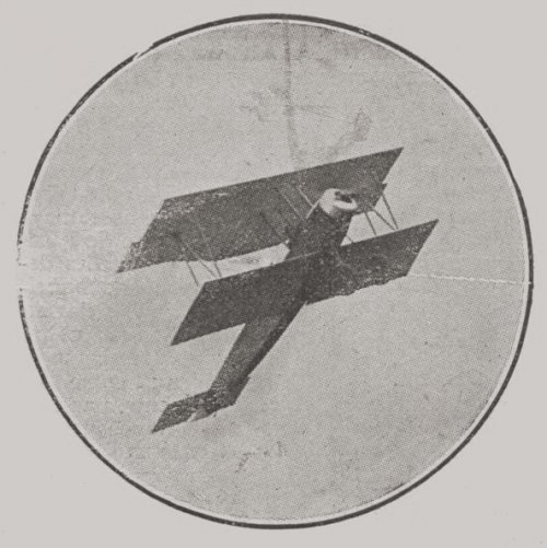

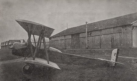

1919 Sport (2).jpg 1919 Sport (3).jpg 1919 Sport (5).jpg 1919 Sport (postcard 1b).jpg 1919 Sport (side view).jpg
The 1919 prototype can easily be identified by its rounded-off tail fin painted in two-tone scheme. Note added headrest in last photo.​
Altogether, Farman produced 34 examples of the diminutive sport biplane (some sources claim 36, perhaps including prototypes). It seems they were all built between 1919 and 1923, and despite the limited numbers, photos show considerable differences between the earlier and later examples, with a few variations in between. Very early prototypes had a rounded off tail fin, but subsequent models had an angular one; the landing gear was modified on the 1922 machines (and described as "clever" by L'Aéronautique). From the beginning, the little biplane was offered with a choice of either a 60-hp Le Rhône 9 Z seven-cylinder engine, an air-cooled 60-hp Anzani 6 B, or a less powerful 45-hp version of the latter. The final two examples (sometimes called the "Super-Sport" or F 210) used the more powerful 70/80-hp Anzani 6 A-2 version.

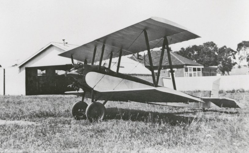

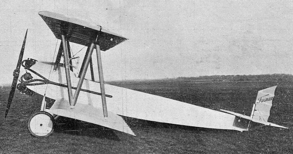

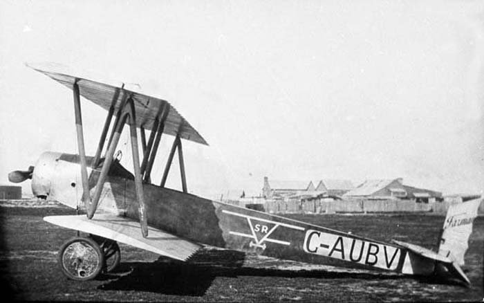

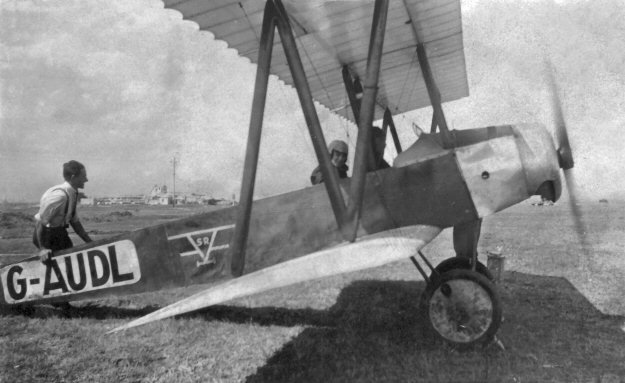

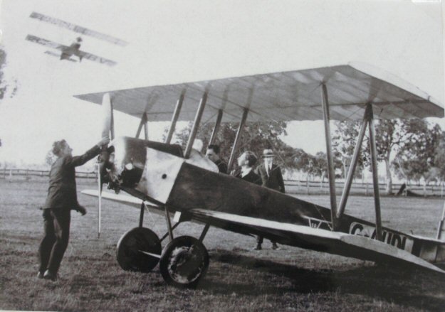

cn 8 [G-AUBV] side view (A.J. Jackson collection).jpg cn 24 [G-AUDL] with [G-AUBV] flying (Kevin O'Reilly collection).jpg cn 24 [G-AUDL] side view (Jim Sweeney collection).jpg 1920-21 Sport (Le Rhône) (plan).jpg
The 1920-1921 production version (variant with Le Rhône 9 Z seven-cylinder rotary engine engine). Note tail fin redesign.​

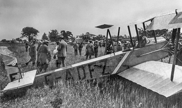

david-6.jpg cn 2 [F-ADFZ].jpg Flight 1921-12.jpg cn 30 [VH-UHL] in the 1930s.jpg
The 1920-1921 production version (variant with the air-cooled Anzani two-row engine). Same tail fin redesign as above.​

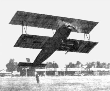

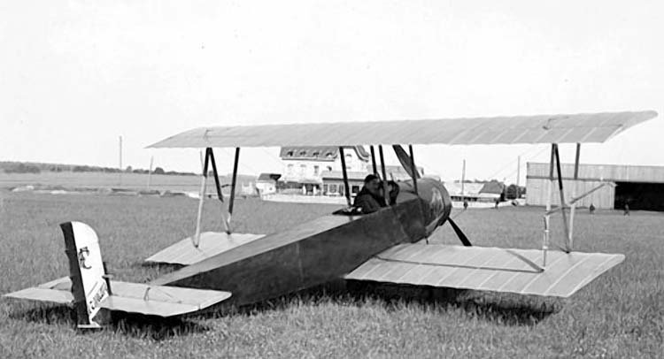

Most "Davids" had straight rectangular wings; however, the fourth aircraft was modified for the Zenith safety aircraft competition in 1920 by increasing the wing area; it can easily be recognized by its wider top wing with a curved trailing edge in its middle section. That same prototype (either the "204" or the "205") also participated in the Prix du Grand Écart that same year. Later on, it had its engine removed for the famous Combegrasse contest in 1922, with the forward cockpit moved to compensate the lack of engine.
1921 Sport modified.jpg 1921 Sport modified at Prix du Grand Écart.jpg ​
The one airplane modified with enlarged wing area for the Coupe Zenith; the same at the Prix du Grand Écart.

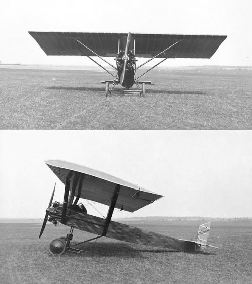

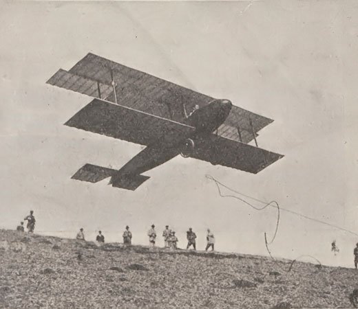

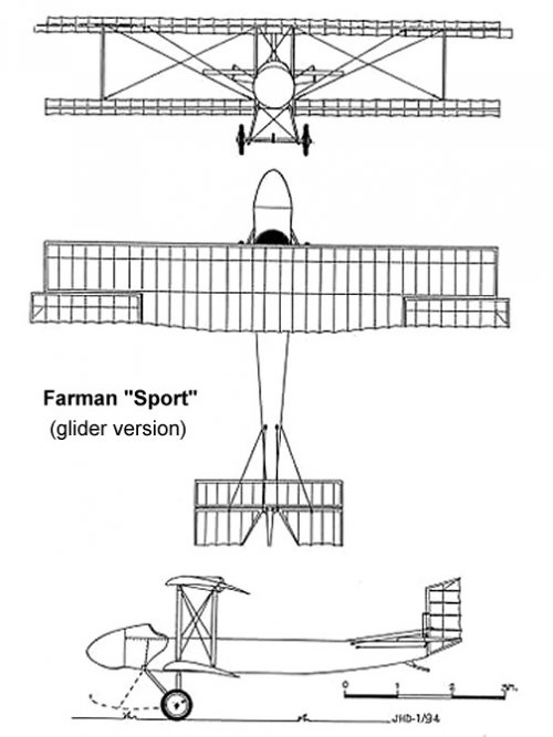

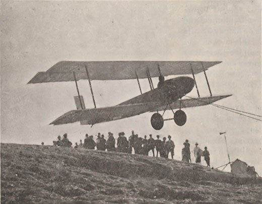

Sport glider (#47) taking off (Le Génie civil, 1922-10-07) a.jpg Sport glider (#47) taking off (Le Génie civil, 1922-10-07) b.jpg Henry Farman, avec Lucien Bossoustrot et Paulhan, devant le David.jpg 1922 Sport glider (plan).jpg
Still the same plane without its engine at Combegrass in 1922. Third photo shows L. Bossoutrot, H. Farman and L. Paulhan.​

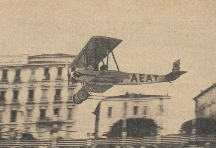

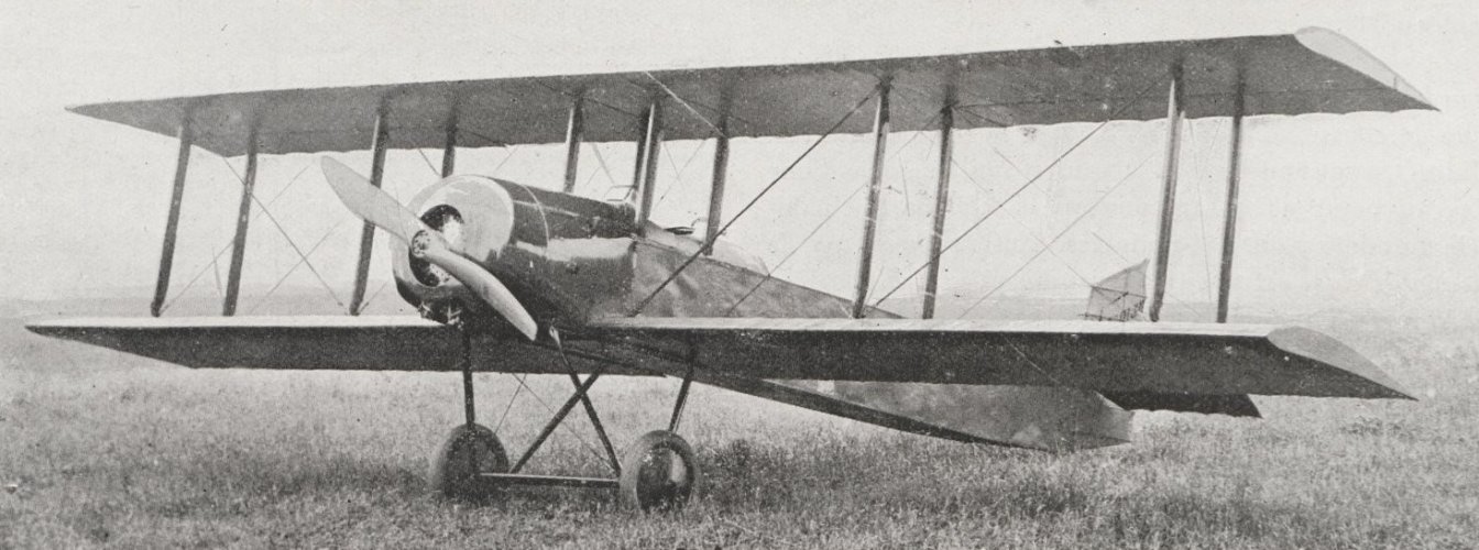

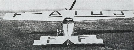

Although the "Sport" was conceived strictly as a civilian type, one derivative was actually submitted to a 1923 military tender for an "avion de premier apprentissage", or primary trainer, differing mainly by its much longer wings and more powerful 80-hp Le Rhône engine. No particular designation seems to have been associated with that airplane, which was not approved and was most likely returned to Farman and sold on the civilian market. Other special modifications included the "207" [F-AEAT] an Anzani-powered "David" with modified structure and landing gear, flown notably at the 1922 Nice air meet; the "F 209" [F-ADFM], a former F.65 modified as a single-seater with modified structure; and the "David Monoplane 210" [F-AIDJ], one of the two "Super-Sports" after modification as a parasol wing type, using a section of the Goliath's wing. That particular aircraft was nicknamed "La carte postale" (the postcard) because of its wide rectangular wing, and was flown in the 1926 Coupe Zenith by M. Coupet. It later had its landing gear moved forward, before reappearing in 1929 as a shoulder-wing type with trapezoidal wings. And if you wonder why the Moustique of 1919-1920 was designated "HF 206", simply look at its airframe: remove the wing and you simply have a "Sport-Farman" fuselage...

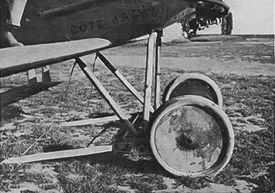

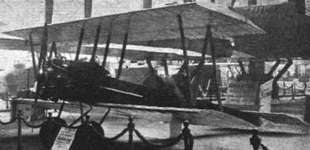

220700_l27aeronautique.png [F-ESAM] enhanced.jpg farman-sport-laeronautique-december1922-b13701-1024.jpg cn 10 [F-AEAT] at the Nice air meet.jpg
The 1922 version boasted a "clever" new landing gear with skids extending aft, acting as a brake and eliminating long rolling of the machine.​

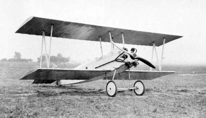

The sturdier look of this American import results from the fuselage being beefed up aft of the cockpit.​
In 1922, C.T. Ludington and Wallace Kellett (later of autogyro fame) formed the Ludington Exhibition Company in Philadephia, Penn. as agents for Farman aircraft, and in 1923 imported two Sports, which were registered [C71] (c/n X-1) and [C72] (c/n 15). The two diminutive aircraft (appearing variously as the Farman Sport or the Ludington Sport) made quite an impression wherever they appeared, taking part in the 1923 Pulitzer Air Race, in St. Louis, Missouri, in the St. Louis Chamber of Commerce Trophy that same month, winning in November the first place of a major competition in Kansas City and also participating in the Saint-Louis air meet**. The latter aircraft also took part with the same aircraft in the Dayton air meet of July 1924, which involved flying over the treacherous Allegheny Mountains. It was the only French machine at the event. That aircraft has survived, and after restoration is now preserved and exhibited at the Udvar-Hazy Center in Chantilly, West Virginia. It is the only Farman Sport still in existence.

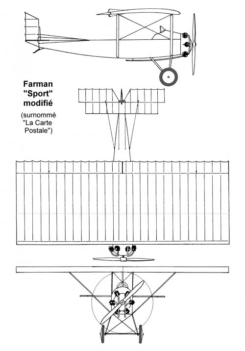

EP2.jpg F210 'La Carte Postale'.jpg F 210 modifié (plan).jpg F 210 shoulder wing modification.jpg
Farman's entry in the 1923 EP2 primary trainer competition was quite obviously based on the commercial Sport but with longer wings.
Other unusual Sport derivatives were the 1924 so-called "Carte Postale", and its later 1929 modification as a shoulder-wing type.
