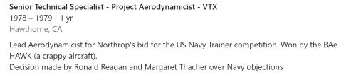

Andrew Skow, ex-Northrop, ex-Eidetic and apparently not intending to do business with BAE Systems any time soon.
https://www.linkedin.com/in/andrew-skow-481b865/
