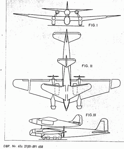

A patent, that later found its way into some projects by Daimler Benz,
proposing the use of a carrier aircraft for launching a fast aircraft in flight.
First patent Nr.62c 27/01-891 658, proposing to carry the fast aircraft
piggy-back, was filed in march 1944. Two months later, an addition was filed,
with the fast aircraft carried underneath the carrier aircraft, so easing the
process of loading and preparing this combination.
Maybe interesting, that the main reason for the carrier aircraft wasn't to add
engine power, but to add wing area. The ratio of MTOW to empty weight for the
carried aircraft was expected to be around 36 tons to 14 tons !
(From Flugwelt 12/1955)

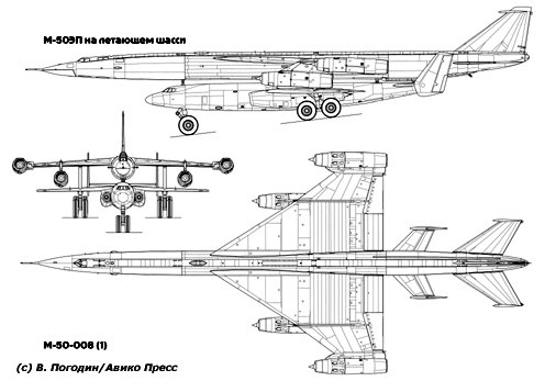

Hi to all!
Only one illustration from hundreds in upcoming book about Myasishchev M-50.

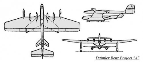

Looks suspiciously like the Daimler Benz A-C projects mentioned (amongst other places) at http://www.luft46.com/db/db.html
Regards & all,
Thomas L. Nielsen

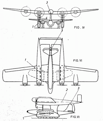

Here the whole patents.
Patent Nr. DE891658
Title: Startverfahren für Schnellstflugzeuge.
Erich Übelacker / Daimler
March 1944
Patent Nr. DE901262
Title: Anordnung zur durchführung eines Startverfahrens für Schnellstflugzeuge, bei welchem das Schnellstflugzeug von einem als Startflugzeug dienenden Lasten- oder Motorsegler startet.
May 1944
https://depatisnet.dpma.de/DepatisNet/depatisnet?action=einsteiger
Maybe interesting: takeoff speed only 105km/H
takeoff field length only 125m
