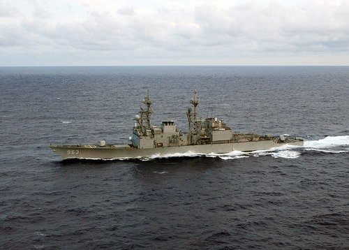

Sort of related question, how come the Valley Forge was decommisioned and sunkas a target after 18 years of service? Apparently intended for a 30 year service life, what was the thinking behind this? Best I could find was a meaningless suggestion that the missile systems were not up top scratch but, with an intended 30 years service life an update was always on the cards. I do wish the military around the world could find a manual on joined up thinking, and read the muddy thing.......

The first 5 Ticonderoga class were built without VLS because Mk41 wasn't ready in 1980 and the Navy didn't want to wait until it was. The plan to re-arm these 5 hulls with VLS during a major refit ran into a lot of cost issues, and keeping them as-was would mean keeping the MK26 supply chain and the production line for Non-VLS Standards going. The Gordon England-Donald Rumsfeld-era Navy decided they'd rather retire the non-VLS combatants way ahead of time to save money than pay for a comprehensive refit plan. To make matters worse, right around 2003 they suddenly fell in love with SINKEXing modern combatants. There's plenty of good reasons to sink a recent ship once in awhile, but it became something of a fetish for the mid-to-late 2000s navy. Valley Forge and twenty five Spruance class were sunk in half a decade.
This has also lead to some theorizing, which may not be far off, that the mass retirements and rapid sinking/scrapping was part of a campaign to pressure Congress to keep money flowing into LCS and the DDG programs.
