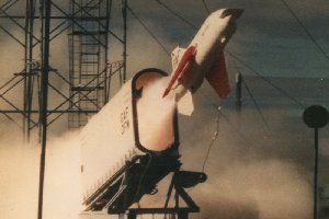

Not sure if it is Super Ikara but this is a picture of a Ikara launched from a canister
That is BOXIK as in BOX launched IKara. It is the basic rocket powered ASW Ikara but with folding wings and storable components.

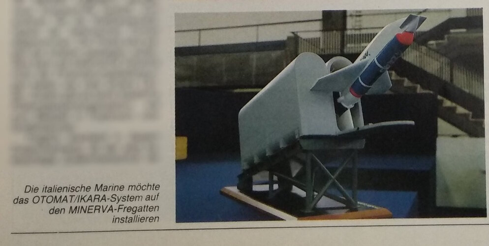

Model of the OTOMAT/IKARA-system meant for the Italian Minerva-class
Interesting. The level of commonality seems low -- pretty much just thew ability to bolt them onto the same launcher frame as OTOMAT?
i have no source on that, but i would suspect that commonality was mainly in the electronics. So data-link, missions-planing, stuff like that. That would also fit well together with the claims made earlier in this thread, that some technology was carried over from OTOMAT/IKARA to MILAS
