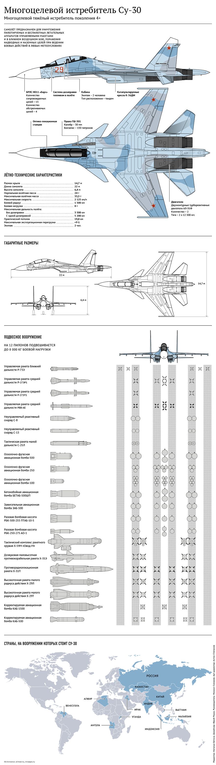

Are you sure? I was comparting the Su-30/34/35 payload configurations and they can all carry 3 KAB-1500. See below. I have not see any heavier weapon used by the Flanker family, except Brahmos in Su-30MKI (2500Kg)
There are photos of Su-35 with 3 × KAB-1500.

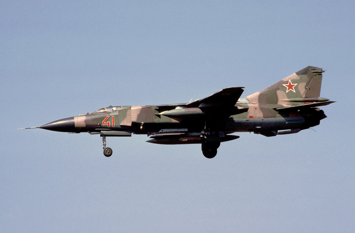

I remember that MiG-23 incident & crash quite well. It passed over my town with the F-15s chasing it and crashed about 40 miles further on a house, killing a young student who was taking a good nap after an exam.
