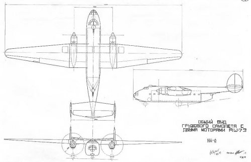

has anyone more info about this Sukhoi assault transport
aircraft project of 1947 ?.

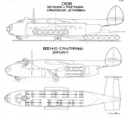

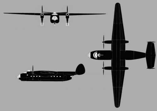

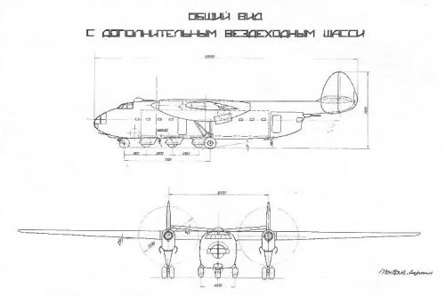

HI hesham
Assault transport - tricycle landing gear but the aircraft
could be equiped with possible 6 additional wheels under
the fuselage for operations on unprepaerd runways.
armement 3 posts: above and bellow and a remote controled 12.7 m/m
machine gun on the lower forward fuselage.
2 klimov vk2 engines
freight compartment load armoread cars with loading hoists -
side opening for cargo.
crew 3 - pilot navigator and gunner
Nothing more.....no specification !
from "OKB SUKHOI. History of the design bureau"
Bye

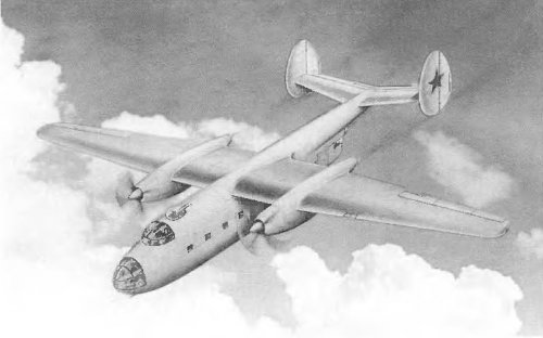

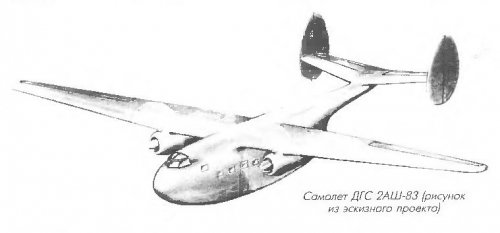

Year : 1946 (summer).
engine : 2 ASh-83 / ASh-73
span : 34 m
lenght : 20,640m
height : 6,5 m
performence:
max speed :415km/h
cruise :318km/h
landing sp. :119km/h
ceiling. 8.000m
armament : top /SEB-3/ 2x20mm cannon
tail /NU/ 2x 12.7 mm BT
weight : empty- 12,850 kg
loaded-26,700 kg

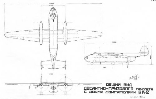

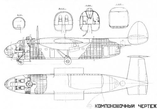

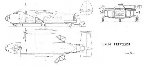

Десантно-грузовой самолет - Assault transport
Year : 1947 (august)
engine : 2 VK-2 of 4200hp
span : 35,30 m
ar.wing : 125,4m2
lenght : 23m
performence:
max speed :580km/h (H=8000m)
ceiling. 11,800m
armament : top /SEB-3/ 2x20-23mm cannon
tail 2x 20 mm
forw. 1x 20mm
weight : empty- 14,104 kg
loaded-29,515 kg
Vladimir Proklov - "Postwar piston aircraft OKB P.Sukhoi - Transport Aircraft"
'Aviatsiya i kosmonavtika' - 11/2007
