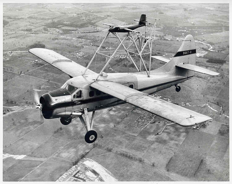

we discussed this strange idea before and Convair had something like this,by using
rail-car to launch airplane;

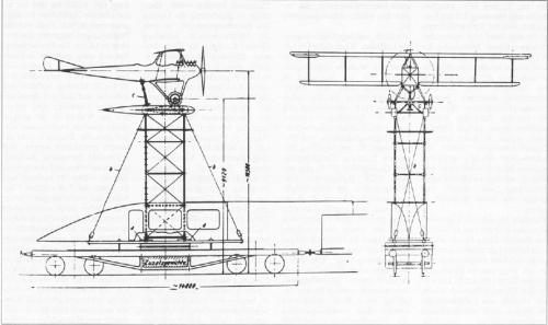

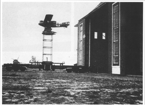

Was this really to launch the plane, or simply the ancestor of wind-tunnel research? I know that such research is still performed nowadays by Scaled Composites, for instance.
Yeah it seems to be for testing, the last Flugzeugversuchsfahrzeug is just directly translated as "airplane test vehicle".
Of course, you are limited to surface pressure conditions using a train.
Skyblazer got it absolutely right, this has nothing to do with launching aircraft, but with
aerodynamic testing only. Just looking at the photos in the linked document from the
Deutschen Museum München (German Museum Munich) already makes it clear, I think.
An interesting document, explaining that aerodynamic research wasn't limited to aviation,
not even before WW II.
And again, if there are documents, sites or other sources, you cannot read, please ask someone
who can ! It's a pity if others are set on the wrong track, or, even worse, if "facts" are created
this way, that in the end are just nonsense.

It was actually a great idea for the time! A captive flight system that could be used to validate aerodynamics during the take off, landing and for many of these early aircraft, the cruise phases of flight. Remembering that steam powered engines operated between 40-65 mph during the same era in which light aircraft typically flew between 40-100 mph. Captive-inactive tests of aerodynamic forces and moments on the aircraft, visual flow using tufts and smoke, structural integrity, flutter, etc., could have been accomplished using the freight car as a moving laboratory with force and pressure gauges to measure lift and pressures along the surfaces. Captive-active tests with a pilot on board could have been used to test flight controls, stick forces, etc.
The problems were probably practical ones, such as not enough quality rail road track to operate at 40+ mph in 1918, the motion of the train and disturbances to the test instrumentation, mounting the aircraft and re-instrumenting it between tests. Once a plane has reached full-scale development it was probably easier to validate the aircraft and its systems by free-flight testing the aircraft instead. Ultimately, as aircraft takeoff and flight speeds increased they would outstrip even the fastest locomotives of the era.
