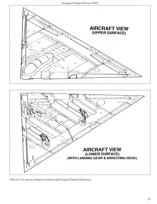

If you look at some of the available drawings online, they are handed and one side was without wingfolds or LEF for instance.

Again, going from the drawings, the A-12 is in dire straits when it comes to carry through. Longitudinally, the wing is cut by structural hollows for the engines, for the main weapons bays, for the landing gear bays and for the auxiliary/self defense bays.
The book mentions that the skin had structural elements integrated within it, like an exoskeleton and the main structure was glued/bolted onto it, in reversal of standard aircraft design.
This means there is little or nothing, _spanwise_ to take the enormous loads of boarding. And even less sign of sufficient volume for integral tanks. IMO, the A-12 could not have a W shaped aft end because the only things holding the structural box together with were integral stringers, built into the wing skins and acting like a Wellington's geodetic structure to permanently flex the wing to stiffness between the forward and aft spars on which they road as cantilevered structures.

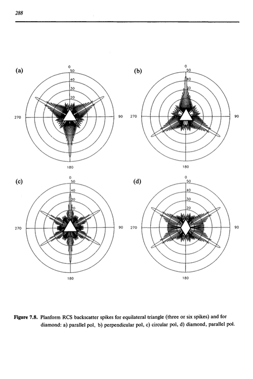

The core low observable problems of the A-12 can be illustrated easily (again) with this set of polar plots from "Radar Cross Section' by Knott:
The straight trailing edge of the A-12 produced strong frontal returns with different polarizations. This is why you do not see straight trailing edges in other operational VLO aircraft. A 3-spike design is not desirable for a strike/penetration aircraft. Instead, a 4 spike design is about as good as you can get.
Plot (d) shows a 4-spike design. At different polarizations it would still have desirable RCS characteristics. The Northrop design would have had a similar 4-spike plot.
The "Ben Rich 3-9 baseline" you refer to from Stevenson is misleading. This was describing Lockheed's work on the A-12 RCS model, not the design of the aircraft. The GD A-12 RCS model was a disaster:

The NavFlir on the A-12 is the IRST. That's why it is labeled as such in the cutaway.
The A-12 has a high altitude, passive, look down, air to air sensor which, in the AAS-42 on the F-14D was said to be 'Sensitive enough for Phoenix envelope shots against the F-117'.
It's noteworthy that the pole the model was mounted to at RAMS was not a VLO (ogive) pole. It was a cylinder.
