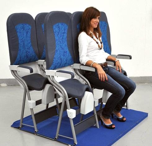

I remember seeing papers on "standing seats" back when I was in engineering school in the 80s. To me these aren't going to happen anymore than rear facing seats (The safest seating position) will, because the people simply aren't going to tolerate them.

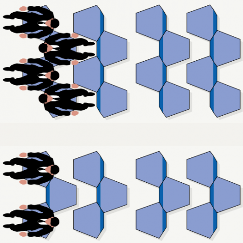

Plus there ought to be hostesses both at the front AND the rear to demonstrate safety measures...
Also, I really wonder how they expect the person looking rear to easily sit and stand up, as there is practically no space to run their legs between the seats.

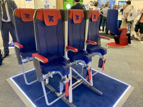

The other problem with standing seating that designers seem to forget about is passengers who can't stand. Both the US and EU have fairly tough regs (US - Air Carrier Access Act, EU - Rights of Passengers With Reduced Mobility When Travelling By Air) that apply to any flight within or into their territory and that means you have to be able to seat both wheelchair users (by having seats we can transfer into) and ambulant disabled passengers, and that can add up to a fairly big group of people when you include passengers (for example many of the elderly) who can walk aboard, but can't stand for an hour plus. So you absolutely need conventional seating in all classes. You can't price the standing seating lower (which ISTR was one of Ryanair's suggestions when this first cropped up), as that would create a discount inaccessible to disabled passengers, which is positively inviting enforcement action (DOT has levied some pretty ferocious fines for ACAA violations), while trying to have mixed normal and standing seating at the same price would create an uproar from passengers expected to use the 'less good' standing seating.
And then there's the problem of children. It doesn't matter if a kid's feet don't touch the ground in a conventional seat, but in a standing seat it's potentially a major problem, and standing endurance again becomes an issue.

Still has the same old problem of being arguably illegal under the US ACAA and EU Passengers With Reduced Mobility legislation. And if you can't sell it into aviation's two biggest markets (and that includes foreign aircraft flying into them) why are you wasting money developing it.
