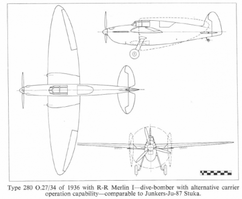

Vickers type 280 midwing monoplane.Mock up produced.It was comparable with the Ju-87.

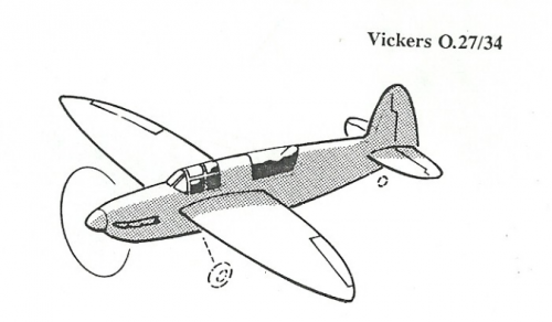

The Vickers Type 280 is shown in the Vickers Putnam volume. Fixed undercarriage and originally to be powered by either a Goshawk or Griffon (no not that one, the Buzzard MS), later a Merlin. The selection of an elliptical wing is interesting, and indeed more Vickers projects than Supermarine incorporated such a wing through the late 1930s, make of that what you will.

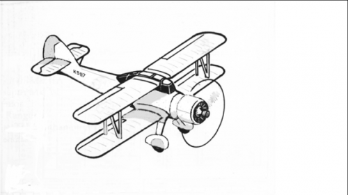

here is a drawings to Vickers Type 280 and Avro Type 666.
