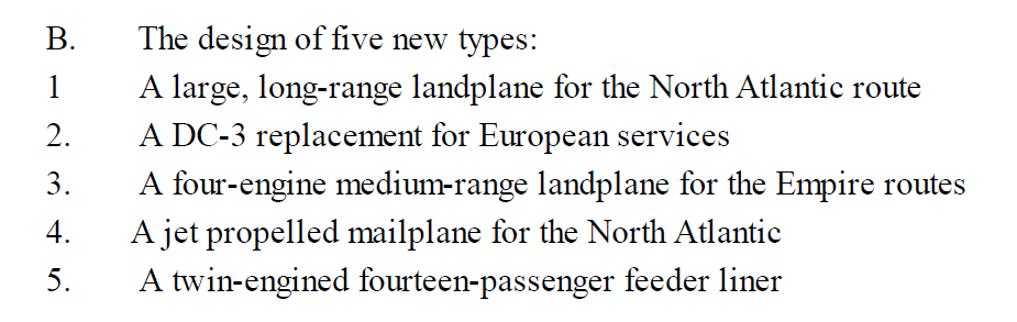

the Brabazon Type-3 or Specification 6/45,the known tenders were;
Airspeed,Armstrong-Whitworth and Avro-692 & Avro-693,but can I ask if those
companies involved or not;
Blackburn,Bristol ,De Havilland,Fairey,Folland,Handley Page,Miles,Percival,Scottish Aviation,
Shorts,Vickers and Westland ?.

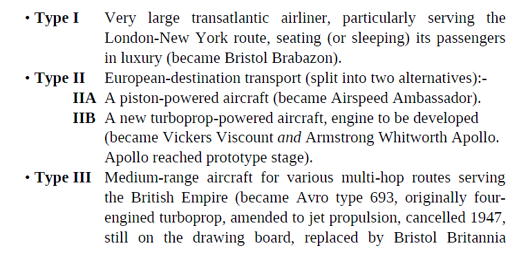

What did the Type 3 requirement call for? From the information in that photo, I assume it was the requirement that lead to the Comet.
The title is the answer,I asked for the contenders ?!.
According to Key Aero:
  • Type 3, a four-engine medium range aircraft, pressurised or unpressurised, for Empire routes (“York replacement”)
According to the same article, aircraft like the Avro Tudor and Handley Page Hermes were part of this requirement. The requirement was split into 3A and 3B, for transatlantic and medium range routes, respectively, with 3A being designated for the Tudor and eventually, the Brabazon. The Comet also began to form part of the requirements.
Unfortunately, I couldn't find much about the unbuilt contenders, although I do remember that Avro tried to license produce the Constellation at this time, and it would have fit the requirements.

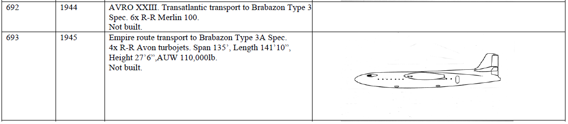

Type 3 was originally split as 3A and 3B but 3B was soon abandoned.
3A included Avro 690 and 692.
Then recast as a medium/Empire route type (1,000nm stages).
For Type 3 Payne has: Avro 693, Armstrong Whitworth (unknown AW number), Airspeed, Miles X14 and X15.
693 won but BOAC declined to order two jet airliners and so was cancelled in favour of Comet.
