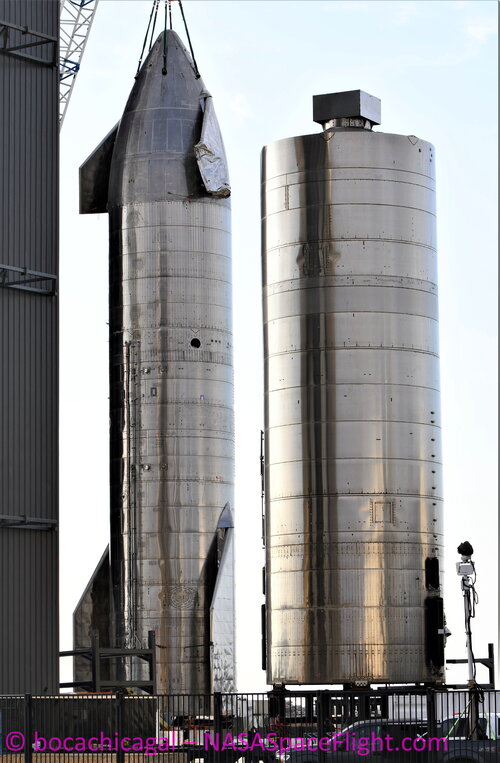

SN9 appears to be in decent condition other than the obvious damage to the flaps; there's some minor warping ('dents') on the tanks, but those don't appear all that worse than what we've already seen on previous prototypes and they should disappear once the vehicle is pressurised.
The bigger concern in my mind is the flap mounting points; the forward flap attachment points and 2/3 attachment points for the rear flaps (including where the actuator attaches) are welded into non-pressurised sections, so they can go nuts with welding reinforcement plates or whatever if any steel has cracked / torn, but the lower flaps do have their upper attachment point welded onto the LOX tank, so that'll need careful inspection. The actuators (specifically their mounts and gearboxes) could possibly also need repairs, though they are required to resist meganewton-metre class torques, so perhaps they'll still be okay here.

SN9 looks like it might be off to the launch pad later in the week if for no other reason than to move it out of the way of the Starships behind it.
I wonder if they can't just pull the flaps off one of the other ones in building to effect repairs more quickly?
I imagine that's the plan, or at least pull them from the flaps destined for a future SN, unless their iterative build program has somehow made the SN10+ flaps incompatible.
If they can weld an entire nose cone onto the rocket on the launch pad, they should be able swap two bent fins.
Also the outter fin shape isn't of that much importance for the low speed flight. I underdtand that it was specified here that the attachement mechanism is the point of concern but an empty Starship tip over with moderate angle should not overload such part (think at the dynamics pressure involved during the flight).

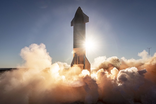

Starship launch
SpaceX’s Starship SN8 vehicle lifts off from the company’s South Texas test site December 9. (credit: SpaceX)
