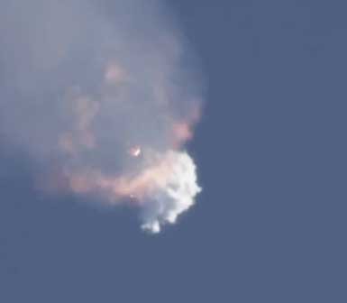

Catastrophic failure of first stage right after passing through Mach 1 around the 2 minute mark. I didn't see any unusual behavior prior to the explosion.
The announcer is now confirming loss of vehicle but they don't know what happened.
Both NASA's commercial resupply vehicles have now suffered a launch failure so this will impact ISS operations.

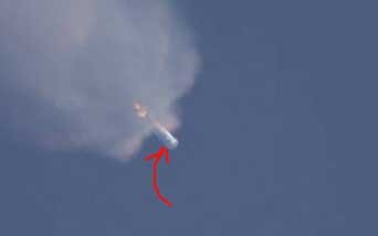

Looks like the whole Dragon decided to completely bail. :'(

Looking at it from about T=2:14 you can see a bright spot near the 1st/2nd stage junction prior to the plume of vapour which appears to come from the same spot at about 2:19...

Fast work in getting that put together.
I seem to see the engines still running even as the vehicle is exploding. The first large white cloud appears to come from above the engine compartment near the area where the landing legs are tucked in. I wonder if something really stupid like pre-mature deployment occurred?

At Maximum Q (highes Aerodynamic pressure on rocket) the Falcon 9 produce a Smoke trail behind it
priore Stage separation, the second stage Tank are Pressurized here the Second tank simply disaggregated at this moment
either the welding on Tank was faulty
or the tank was damage by some thing at maximum Q by ice or one of cover blow off denting the tank.

At the 2:16 mark, 2 white spots appear near the bottom of the payload shroud. I don't remember seeing those on prior launches (during first stage boost phase). Well the announcer indicated that they had a lot of telemetry data so Spacex may be able to isolate the cause relatively quickly.

Tweet from Elon Musk: "There was an overpressure event in the upper stage liquid oxygen tank. Data suggests counterintuitive cause."
That is just airpressure man. It is around solar panel covers, nothing to see here.

they have identified the cause
in Second stage, Inside Lox tank one of steel stud holding Helium tank, failed at 1/5 of load it design for.
it rupture it connected Helium tank, what released it entire content at once, leading to overpressure that let to burst asunder of second stage
