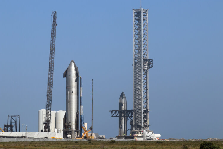

biggest issue is launch cost and refurbish cost for the Launch Pad.
if that labour intensive with allot personal, this will be very expensive.
if SpaceX manage to automate the launches and refurbish the pad, it will save allot money.
