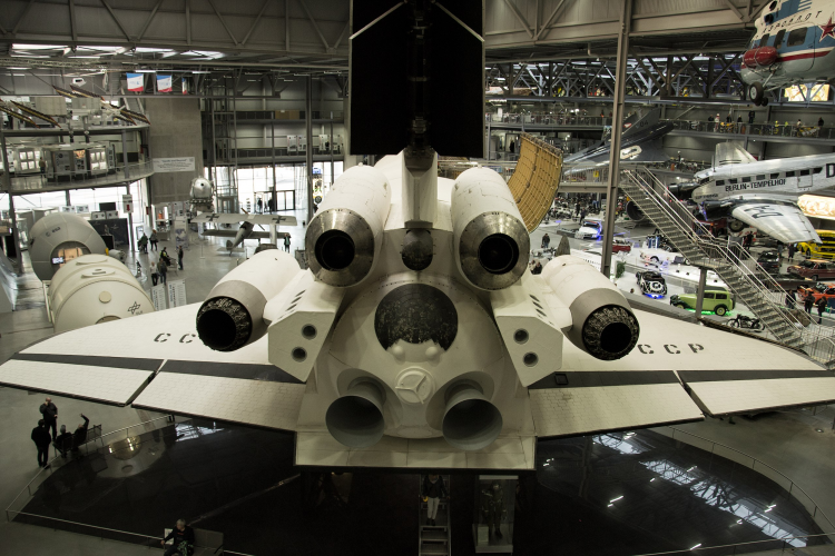

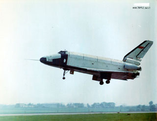

Don't forget that the Soviet Shuttle, Buran, prototype was powered by 4 jet engines mounted on the aft fuselage.
I know that. It was the equivalent of the enterprise Ie it never went to space.
Any news of this peculiar article? I mean, in 2000 it was showed in australia, after a bankrupcy it was shiped to the EAU, then the sinsheim museum tried to buy it...

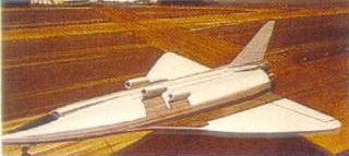

Based upon the description given by the excellent Jenkins' book, that's my personal interpretation of the 5 engined air-breathing Shuttle.
The position of the jet engines makes them extremely vulnerable. If to place them somewhere, than the best position is to move them aft above the wing.

I suppose that's the main reason which forced the Russians to place the engines in the aft-end of the fusalage in the Buran Analog (or "Aero-Buran").
i've seen a drawing of the shuttle orbiter with the jet engines mounted underneath, i'm sure it's in one of the Jenkins' Shuttle books, maybe the first one, the one in the 'aerofax datagraph' series.
cheers,
Robin.

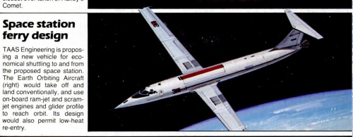

the TAAS Engineering created a ferry aircraft for space station,used ram-jet and scram-jet
to reach orbit.
http://books.google.com.eg/books?id=HuMDAAAAMBAJ&printsec=frontcover&dq=popular+mechanics+1986&hl=en&sa=X&ei=6GwAVLWWEKmu0QW02YGQCw&ved=0CCsQ6AEwBDgK#v=onepage&q=popular%20mechanics%201986&f=true
