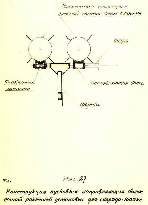

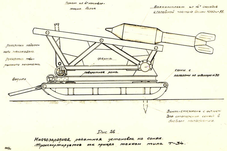

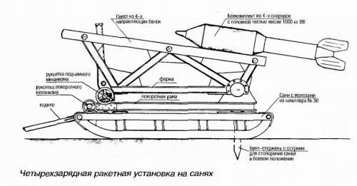

I've just read in Shirokorad's "Tank war on the eastern front", that RNII designed and built a heavy demolition rocket intended for use at the Mannerheim line in Finland in early 1940, in conditions of deep snow.
The rocket is supposed to carry a 1000 kg warhead (!) at the range of 2-3 km, i.e. it was much bigger than e.g. the huge 250 kg TT rocket of 1933.
Two types of launchers for four projectiles each were developed, one was to be mounted at the back of the T-34 tank and was to be jettisoned after launching rockets in a salvo, the other was designed as a steel sledge with rotating launcher on it, to be towed by a medium tank.
The latter launcher was actually built and sent to the Leningrad front in early 1940 but not used in combat.
Are there any further details known about this mysterious weapon of 1939? Any data? Actual designation?

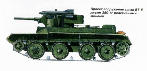

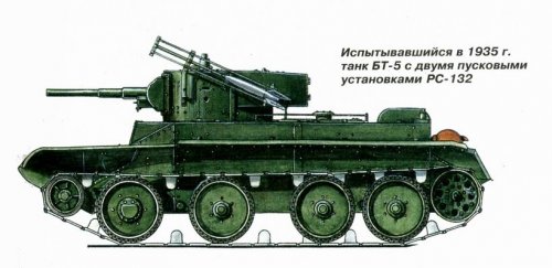

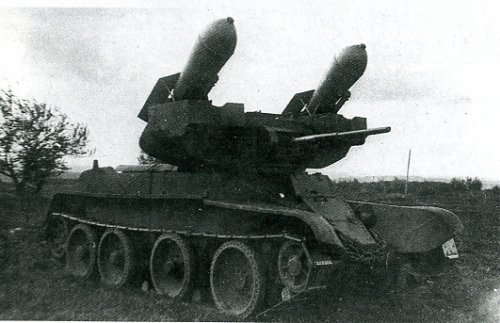

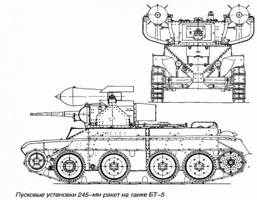

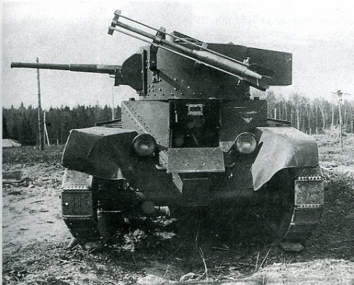

I recently obtained a Russian book on the BT tank and it has a photo of a BT-5 rigged up with two of the TT rockets, one on each side of the turret. The text is in Russian sadly but I'll post a image from the book showing the BT-5 mounting the rocket system once I'm back at my library with due credit.
So far, only images, additional text (translated) if necessary, send in the evening.
Shirokorad "Encyclopedia of the national missile weapons. 1817-2002"
A. Solyankin, M and I.Pavlov's, I.Jeltov "Russian armored vehicles. Twentieth century"

Thanks!
I came across the description in Shirokorad's "Encyclopedia..." in the meantime - it actually contains the same facts as the "Tank war..." plus the drawing (Shirokorad usually repeats the same chapters in numerous books). But I don't like the rocket in this drawing - it looks like a retouched usual M-13 added to an original drawing just to make it more attractive. For example - RS in 1939/40 had plain sheet metal fins, without ribs introduced by M-13 only.
The "Tank Torpedo" rocket and the experimental RS-132 installation on the BT-5 are a different story sadly. :-\

Same photos in the book I have, Танки БТ.

What's the weight / designation of these?
http://www.secretprojects.co.uk/forum/index.php?action=dlattach;topic=7823.0;attach=103054;image
(the BT-5 with two big rockets on top)

The rocket was called TT or Tankovaya Torpeda (e.g. Tank Torpedo). It was developed in early 1930s, while the prototype RBT-5 tank was tested in 1934. The TT had 420 mm calibre, was 1805 mm long and weighted 450 kg, including 250 kg HE. The max. range was 1500 m.
The rocket was found to be inaccurate, with too short range and complicated reloading.
Shirokorad also mentions 250 kg Tank Torpedos of 245 mm calibre, tested in 1936.

So the drawings are genuine though, thank you! :)
Just the rockets are described as carrying 1000 kg HE - so the whole rocket could be probably even twice as heavy. :eek:
