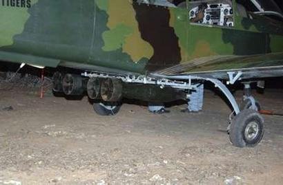

Dear Jambia your idea sounds right a plane just with the size of Zlin-143 used by Tamil Tiger rebels that's one great idea by the way
