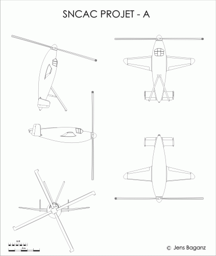

Main source for the three VTOL designs was the book "Les Giravions" by N.-F. Navard, which was discovered
by our forum member boxkite several years ago. The first design, "Projet A", was a tailsitter with a single large
rotoprop, probably tip driven as no means of torque control is visible.

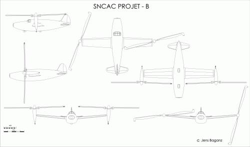

"Projet B" was a tilt rotor design. No data were mentioned and the drawings in the book were quite basic, so
details like cockpit and landing gear were largely guesswork, based on an expected "family likeness" with other
SNCAC types like the NC.1070/1071.

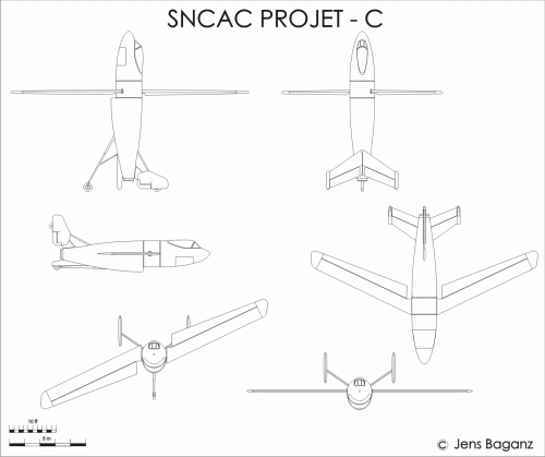

A little bit more information was given for "Projet C", a tail sitter somewhat resembling the Focke Wulf Triebflügel,
but with the wings fixed in horizontal position for cruising flight : Weight about 3 tons (no mention if empty or gross
weight), range/duration 2000km/4 hours with a speed of 580 km/h, or 500 km with a speed of 800 km/h and a maximum
climb of 30m/s with reheat.
