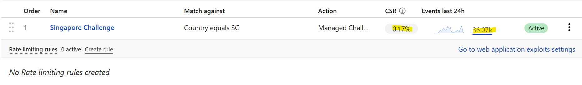

36,000 +requests from Singapore, only 0.17% CAPCHA's solved.

I actually think its improved the site speed generally, but more importantly I now have the ability to rate limit, block and otherwise defend the forum from such traffic.
